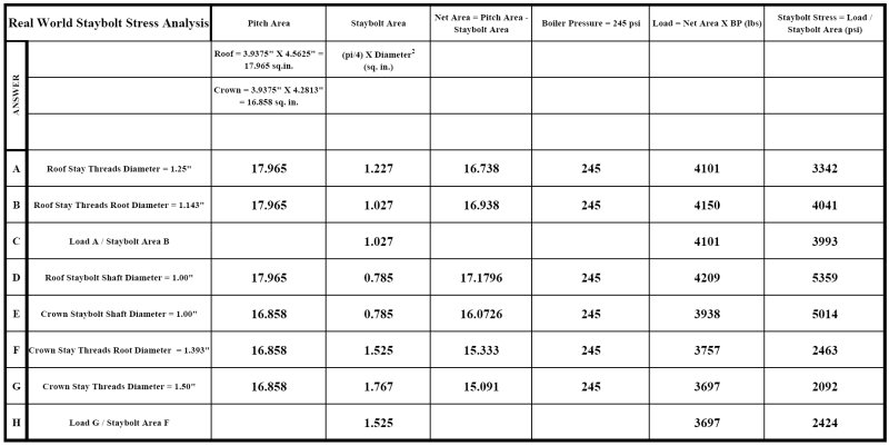

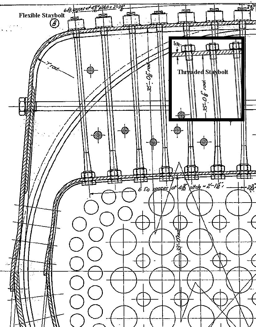

The calculations are provided. Those who have correctly filled out an FRA Form 4 should immediately know the correct answer. The blueprint shows the first three rows as flexible staybolts. For the purpose of this poll, the roof threaded staybolt ends are shown.
Poll will run for 7 days to give the weekend for those may want time to verify calculations.
Longitudinal Pitch = 3-15/16 inches = 3.9375"
Roof Transverse Pitch = 4-9/16 inches = 4.5625"
Crown Transverse Pitch = 4-9/32 inches = 4.2813"
Staybolt Material is 1.00" Diameter
Roof Sheet End is upset to 1-1/4" Diameter
Crown Sheet End is upset to 1-1/2" Diameter
Thread Profile is Whitworth Pitch = 12 TPI (p=0.0833 in.) (d=p x 0.64033)
Staybolt Shaft Diameter = 1.00" Area = 0.7854 sq. in.
Roof Stay Threads Root Diameter = 1.143" Area = 1.027 sq. in.
Roof Stay Threads Diameter = 1-1/4" Area = 1.227 sq. in.
Crown Stay Threads Root Diameter = 1.393" Area = 1.525 sq. in.
Crown Stay Threads Diameter = 1-1/2" Area = 1.767 sq. in.

Stress is a function of geometry only.
Once the stress is determined, then the stress value and application environment determines the material selection.

It doesn't friggin matter. The question is about the amount of stress on the bolt, not whether a theoretical bolt made of any particular alloy or material can withstand it. The cross section of the weakest part of the bolt, or of the weakest attachment if that's less strong than the smallest cross section, provides you with the amount of material X that has to withstand the stress - PSI times the quantity of square inches of plate that particular bolt is handling - it's share, in other words...... so whatever material it is, it needs to withstand so many pounds of force per square inch for the amount of cross section that is weakest. We know what the pitch areas are, and what the dimensions of the bolt are - might need to apply a little trigonometry to work the angles....... which if I wasn't an English major I might be able to do.

So I will go out on the limb. The question is “What is the staybolt stress for the FRA Form 4?” I will assume that the math is correct. So the answer is 5359. The FRA is not a complex organization that spends a lot of time getting all philosophical. They want to know that the values are within parameters and was it accurately determined. So, state the highest stress calculated and have done with it. Material isn’t the issue, design and construction are not the issue, and pressure isn’t the issue. Unit stress is the issue. Material, design, construction, and pressure come into play elsewhere.
CCdW

 Post subject: Re: What is the staybolt stress?
PostPosted: Fri Aug 28, 2015 6:15 am
Posts: 489
Actually, no. The wonders of the Belpaire firebox is the crownstays are radial and perpendicular to the roof and crown sheets. No fancy calcs required.
