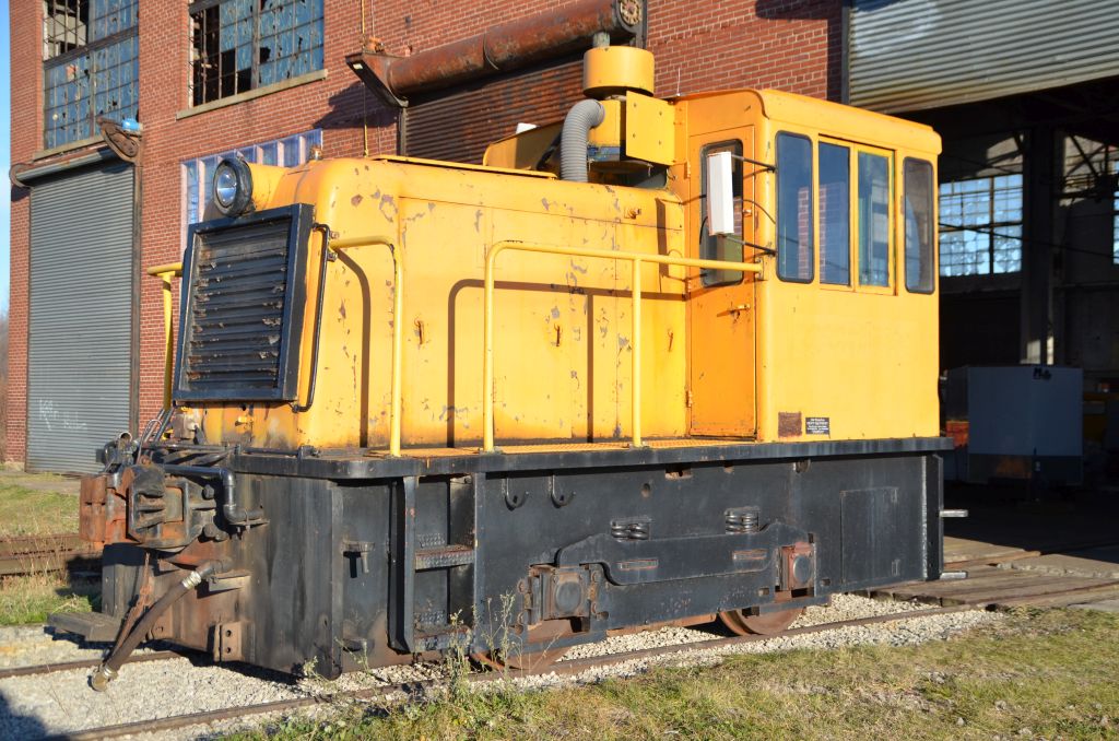

On November 30th, the Niagara Railway Museum Inc. moved its newest acquisition, a 1948 GE 25 ton diesel from the former BF Goodrich plant in Thorold to our site at the CNR diesel shop in Fort Erie. The locomotive is in operating condition and was driven onto and off of the float. It will come in very handy at the shop and was the first locomotive to fire up and move inside the shop since the late 1980's. The entire story, with pics and the video link can be found at http://www.nfrm.ca/blog

BTW, what is the contraption around the exhaust stack?

Posts: 243

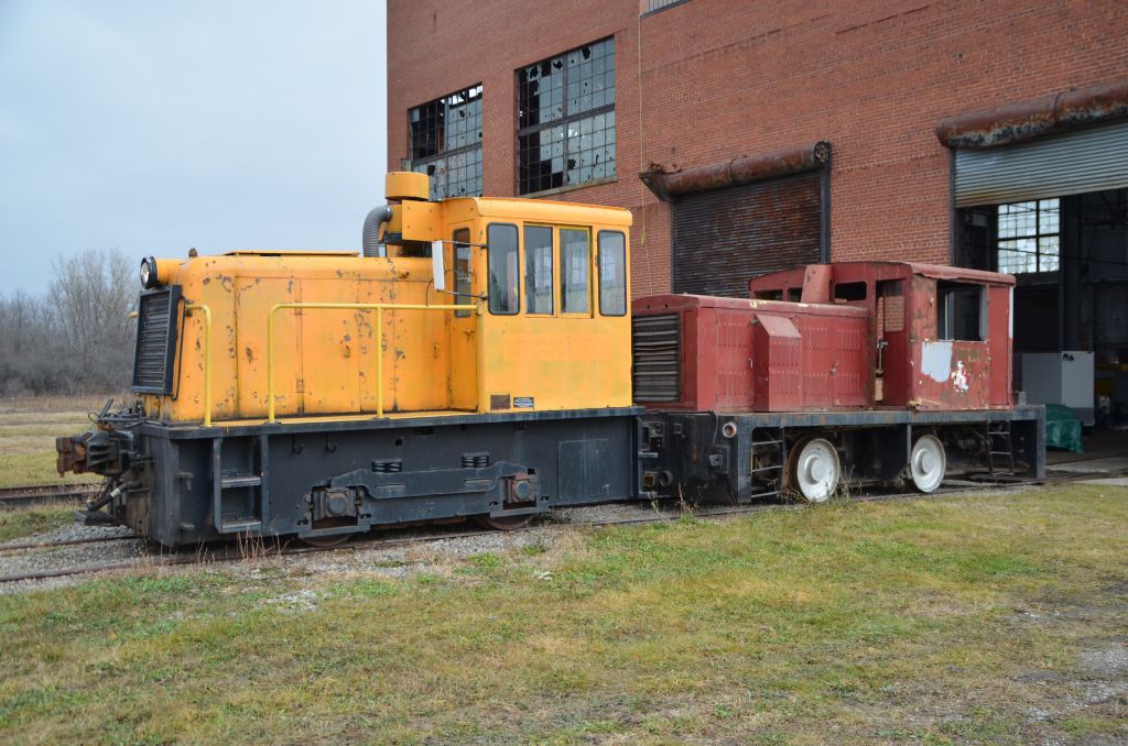

David. I believe it is an air filter system. Obviously a bit of a modification. I hooked the bell back up today, just had to replace the air line. I am however having a bit of an issue. It keeps wanting to load as soon as you put it into forward or reverse. when ya knock the brake off it starts moving. And I haven't even touched the throttle yet. When I pull the throttle out, it picks up so fast the wheels start spinning. I need to keep some brake on to control the wheel spin. Seems to me that's NOT a normal thing. Anyone with any thoughts on that??
Today I decided to pull our Plymouth MDT40t outside and get a pic with the 2 of them together.
