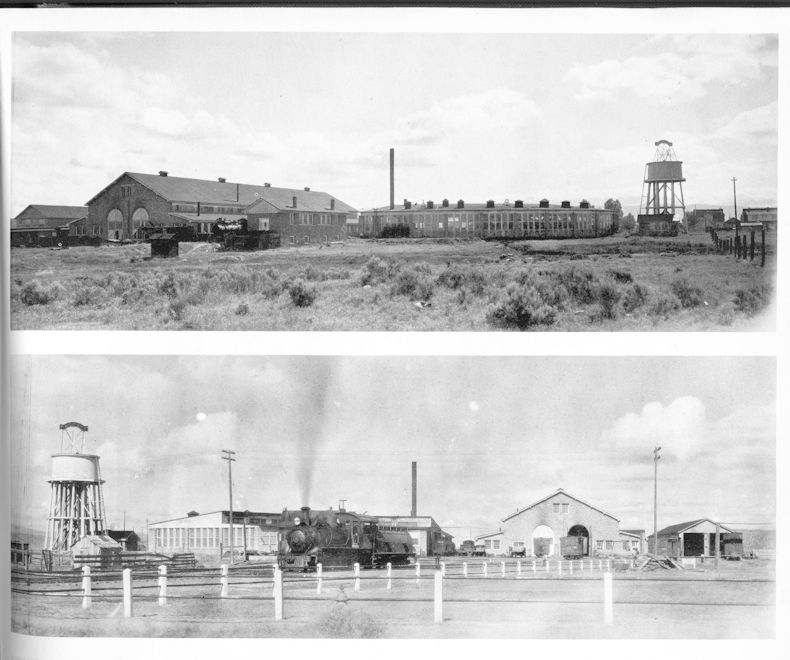

The other thread about the RR Museum of PA roundhouse proposal made me wonder about roundhouse designs.
The 3' gauge Nevada-California-Oregon moved out of Reno, Nevada, in 1917-18 and established new operational headquarters at Alturas, California. One of the new facilities constructed was an 8-stall roundhouse. This building had large glass windows on the rear and the sides.
Below is a reproduction of two Southern Pacific photos showing the roundhouse that were used in David Myrick's Railroads of Nevada, Volume 1.
How does this compare with other roundhouses built later?
File comment: N-C-O Alturas Roundhouse

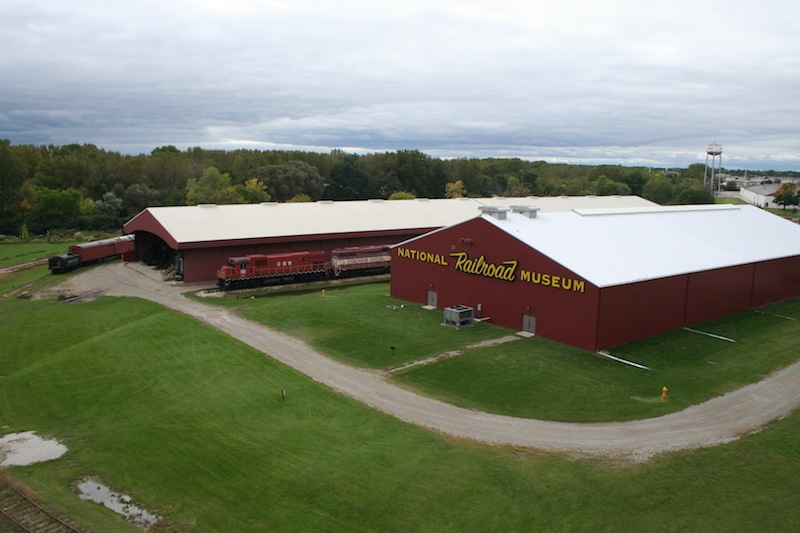

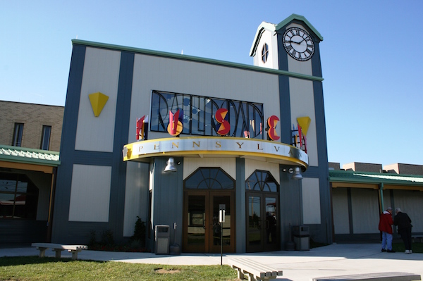

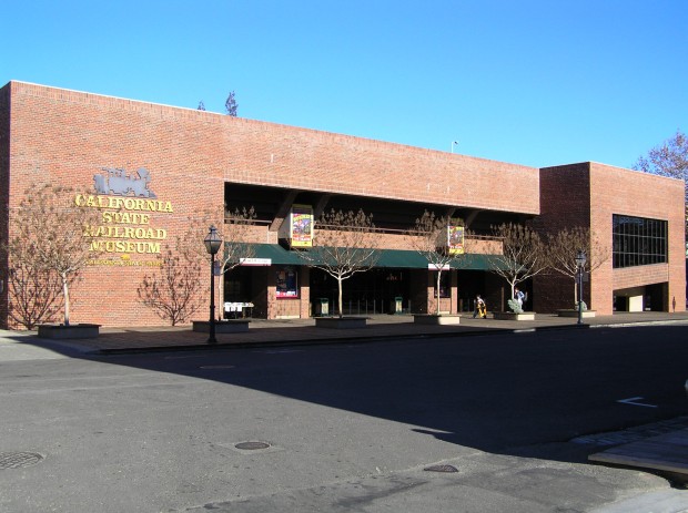

Hot Metal wrote:
Buildings for museums should not "make a statement", they should be appealing but should not in any way take the attention away from the mission of the facility.
I was not a fan of Graves, and his building unfortunately caricatured industrial architecture, but all buildings make statements, so it is better to exercise some control over what that statement is than to reject the power of architecture to support your museum.
I don't like the design, but I'll wager Graves involvement meant something to the museum's major donors.
What do you think each of these says about their respective institutions?
Victor_McCormick_Train_Pavilion_and_Frederick_J_Lenfestey_Center_at_National_Railroad_Museum.jpg
Victor_McCormick_Train_Pavilion_and_Frederick_J_Lenfestey_Center_at_National_Railroad_Museum.jpg [ 210.31 KiB | Viewed 10547 times ]
