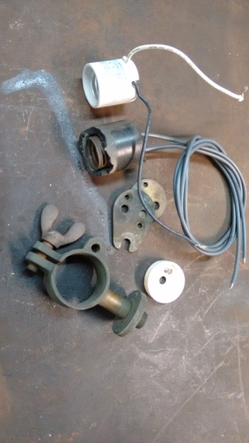

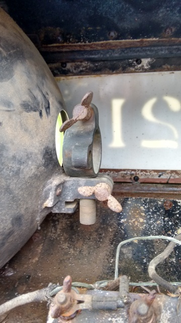

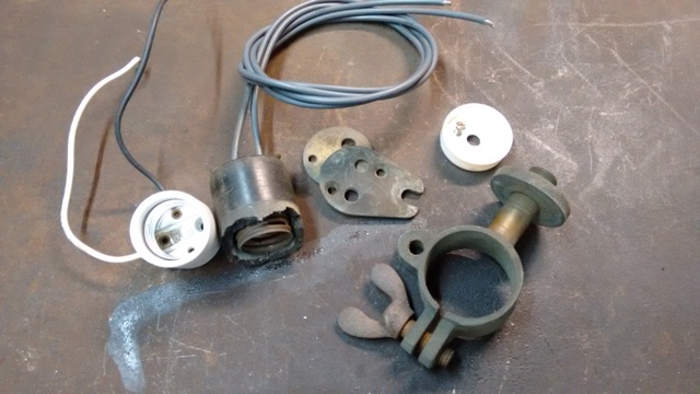

I am in the same dilemma. Probably a lot of possibilities out there. Anybody have dimensions on an EMD 8228323 is a lamp receptacle used in number box and walkway light applications?
I happened upon in my "shop" a ceramic fixture. Was thinking about making a sleeve to mount it. Would prefer a closer to original.
A ceramic 3d print might be the answer. I have done 3d design and printing. I might have to see if I can produce a 3d solid suitable for printing.
Dale Grice

 Post subject: Re: Pyle National Headlight Socket
PostPosted: Wed Dec 02, 2015 11:01 pm
Posts: 512
Well, if the ceramic socket has a smaller outside diameter than the clamp it may be easy to make a split bushing that clamps the outside of the ceramic socket and slips inside the clamp. If you cut a slit along the length of the bushing (with a handheld hacksaw) you can probably "bridge" the gap in diameters. The clamp will compress the split bushing and provide a firm grip on the ceramic socket.
Some plastic like "PEEK" would probably work fine in this application. I would avoid making a metal bushing (brass, etc) since the temperature change (bulb lit/bulb not lit) would cause the brass bushing to expand and press too hard on the ceramic socket. Ceramics do not like being compressed.
Get a 3 inch long "chunk" of 1-1/2" and make a bushing. Probably last another 50 years.
http://www.mcmaster.com/#7269k12/=102lhbh
But you need a basic machine shop (lathe) to do this.
If that is not available you may be able to wrap the ceramic socket with some tape and make it work for a while. Something like this might work;
http://www.mcmaster.com/#7438t11/=102lifi
Cheers, KevinK
PostPosted: Thu Dec 03, 2015 12:40 pm
Posts: 497
Location: Northern California
We would probably have made a new socket holder out of linen reinforced phenolic rod or tube. In time that aluminum socket will probably give you trouble. It is not intended for use in a damp location, you should look for a brass one.
