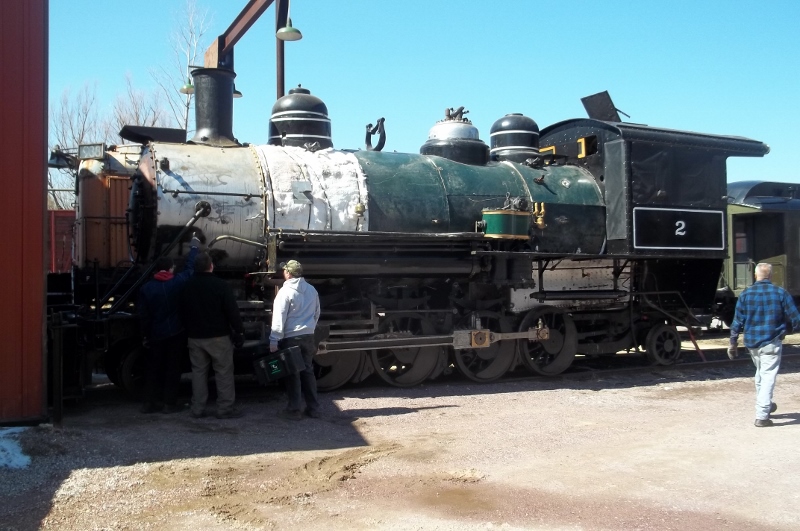

Much progress has been made on the Saginaw Timber No. 2 since the first fire-up in November. The major problems of the first fire-up were the placement of the atomizer and repair of the firing valve. Both of these items have been tackled and reassembly is progressing. Installation of lagging and the wrapper sheets began in February and will be completed by the end of March. This last weekend the locomotive was moved out of the engine house for installation of the cab and turbogenerator. Plumbing on the back head and electrical work can now be completed.
A punch list of 35 items has been made to guide the final reassembly prior to operational testing, tentatively scheduled to begin May 4. The list includes everything from lubrication lines to double nutting all bolts and studs.

Picture of the cab installed, 3/28/15.

I like it when big pieces go back on. Nice photo's guys and good job too. Was kind of hoping the jacketing was done so I don't have to help with that last course. OF course that should be the easiest section to do, as the second to last wasn't that bad. Will see if I can make it down sometime this week. Meetings and last minute call ups are keeping me close to home.
How are we coming on the mud ring bearing block revision? Would be nice to get the communist side plates and brake rigging back together again. I thank you guys for stepping up and pushing this project forward. It needed a couple of extra bodies and a goal deadline to fire up. This is how to get things done. It is how the museum got to where it got. Membership pulling together is a great concept and it works! You guys rock.
Cheers, John.

John, you'll be glad to know the last course of jacketing was applied Saturday afternoon.

Richard you tricked me and that isn't nice. The last course was not done!
Old home week today. Some old time members who were around in the late 60's-70s were around today including a UP car knocker from Denver. Funny how we all have aged. Not funny really. Anyway still got a few things done. Delivery pipe from injector to check valve installed on fireman side installed. A couple of studs were too long and under the jacketing which interfered with fitting the jacketing were nipped off. The mounting bracket for the steam generator was on backwards so now the jacketing fits better and the generator is mounted as the holes line up better, and the jacketing is tightened up on the top side. Think some final fitting might be in order around the rear sand dome. But for all the fine visiting that occurred we actually did a few things today. Not sure if most people realize all the nickel dime things that go into a locomotive. Endless details that nobody will ever recognize but still have to be done. Wonderful way to spend the day.
