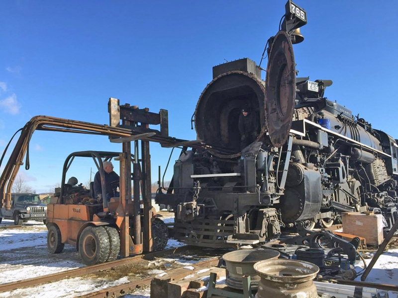

I know 2020 is a few years away and 765 will need its annual overhaul. I wonder what will FWRHS do to in those three years. Will FWRHS keep doing excursions with another Locomotive or will they just stop and work on the 765 for those years. If they do operate another locomotive I thinking they would use PM 1225 for those three years and give 1225 more mainline work that she was built for. It's just a thought.

its last overhaul was a biggee, 13 years, but maybe all that major work is done and perhaps it only needs flues and a good checkover for anything else.

If it does mean anything else, FWRHS has been doing some maintenance during 765's down time. Last year they did the chimney and top of the smokebox around it (if I remember correctly), and this year they're replacing some of the older sidesheets on the firebox.

The FWRHS has been eyeballing 2019/2020 for a while now and in concert with our local FRA inspector have actually started on the 1472-day inspection early. Early as in, a month ago. We're actually pulling superheater tubes about twenty feet away as I write this.
Tubes to follow. Additional work to follow next year. This way the downtime is absolutely minimal and we draw on the $250,000 in escrow for the inspection over two years. The running gear and the locomotive overall are still in very good shape compared to 2001.

I'm certainly no expert but by doing the tubes now doesn't that restart 1472 clock? I'd think you'd want to wait as long as possible before pulling the tubes.

Yes, but we don't think anything will compare to waiting from 2005-2009, when the engine sat with boiler time ticking away. We lost a lot of tube time that way.
The 765 experienced a leaking flue and cracked tube last season and we're not content to wait for others to do the same. We detailed this in our last member newsletter and I'll be posting the story and some additional details in a few weeks.
