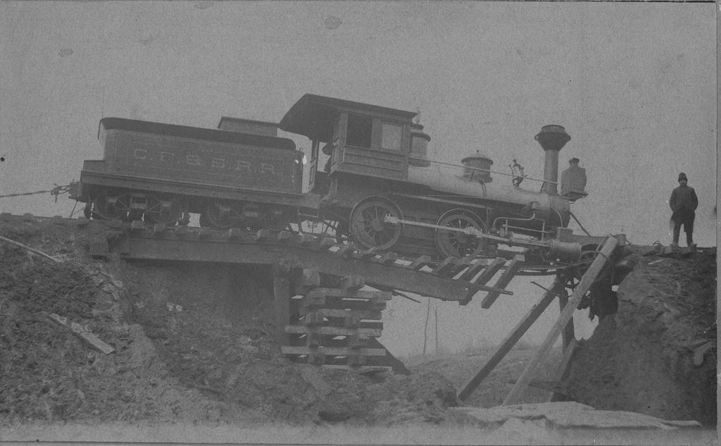

Looks like builder #638 matches the best. William Hutchings was the traffic manager of the CF&S. Interesting how it says its #2, in the photo I have its numbered 3. Photo attached is most likely one of its first runs on the line. Thank you for the information.
File comment: From the Chagrin Falls Historical Society

I was judging it based on your information you gave me and other information I was able to find. The name W.M. Hutchings matches up since he was one of the board of directors, and 1884 is the date that matches the Ohio Annual Report of the commissioner of railroads and telegraphs. It shows a locomotive was added during the year 1883-1884 and the railroad only owned (to my knowledge and evidence I've found) 1 other locomotive which was a 0-4-0 built around 1876 for the Painesville, Canton, and Bridgeport Narrow Gauge railroad. I did find another photo of the same locomotive I attached which has lettering added on the tender showing CF&S R.R. from around the year 1887.
