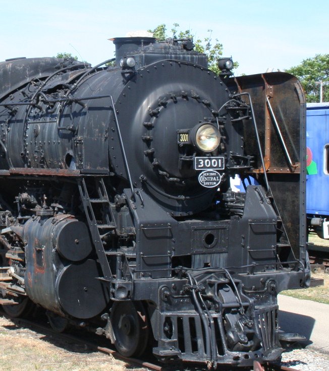

Les ( and the forum )
Here is a close up of the front of the engine, that ilustrates the original subject matter .
Just out of curiousity.... perhaps someone could share ( as I don't know the answer ) .. Was this originally a private type museum, that somehow was taken over by the City of Elkhart ? An interesting twist to have a city run a railroad museum.
Dean

That is the first picture I have seen of them. It looks like the fabrication is accurate. I can also tell that the Indiana weather is taking its toll on the outdoor equipment a date with the spray gun will be needed again soon. The last time was 5 years ago now.

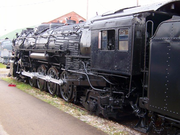

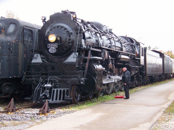

Here are a couple of pictures just after repainting in 2007.

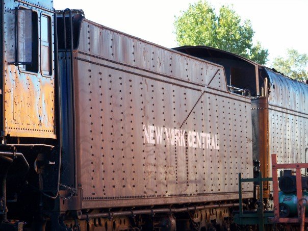

Mr. Moxley..
per the City of Elkhart's website...
-New York Central L-3b 3042's tender, used as an auxiliary water tender on the American Freedom Train and the Chessie Steam Special.
I also include a picture from the other day
Dean

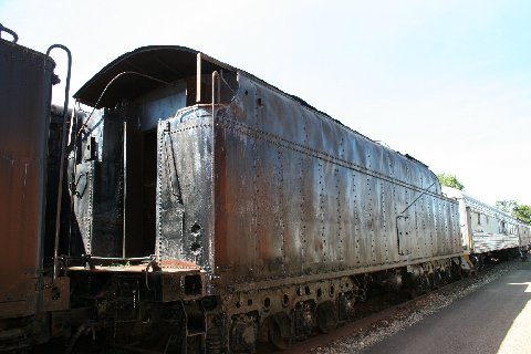

EMD,
Dean is correct as to the origin of the auxiliary tender, if the Sun is shining on it just right you can still see where the AFT stripes and stars were along with where the CHES of Chessie System were. The tender was in the roundhouse fire with the 2101 and all those markings were burned off, but the metal and different rust patterns. When we repainted it in 2007 the plan was to just get it black again. Therefore we used a direct to metal paint that required no prep. Once the paint was on it those markings showed up very clear.
As far as how it was required Bob Spaugh told me that he acquired it from Ross Rowland but I do not remember the details. Maybe Ross can shed more light on that.
The 3001's original tender had the sides modified in Texas note how the curved tops were cut off. It also has a fake oil tank welded over the coal bunker. That has kept the rain and snow out of the tender and the coal bunker is in very good shape.
The plate that you can see on the 3042 tender about midway on the fireman's side is not on the 3001 tender. That is where the stoker motor was. The motor was removed and a smooth patch was welded in by the T&P (note the difference in the rows of rivets). The stoker screw was cut off flush with the front of the tender. Just as getting the smoke lifters back on the locomotive the tender sides have long been a topic of discussions about getting them restored.
Mark A. Frazier
