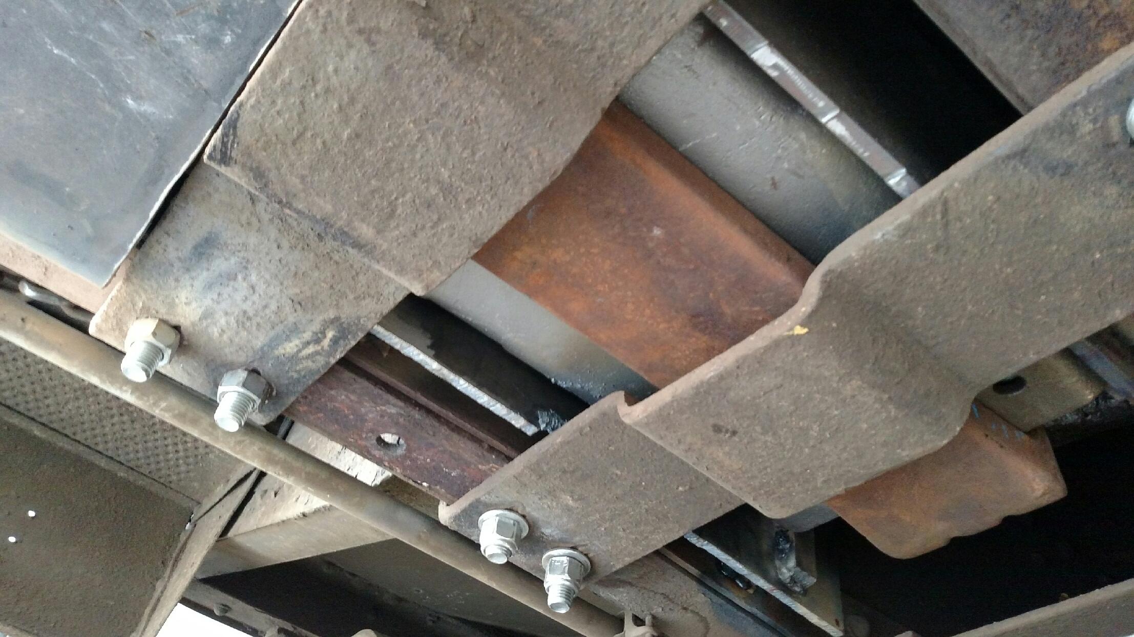

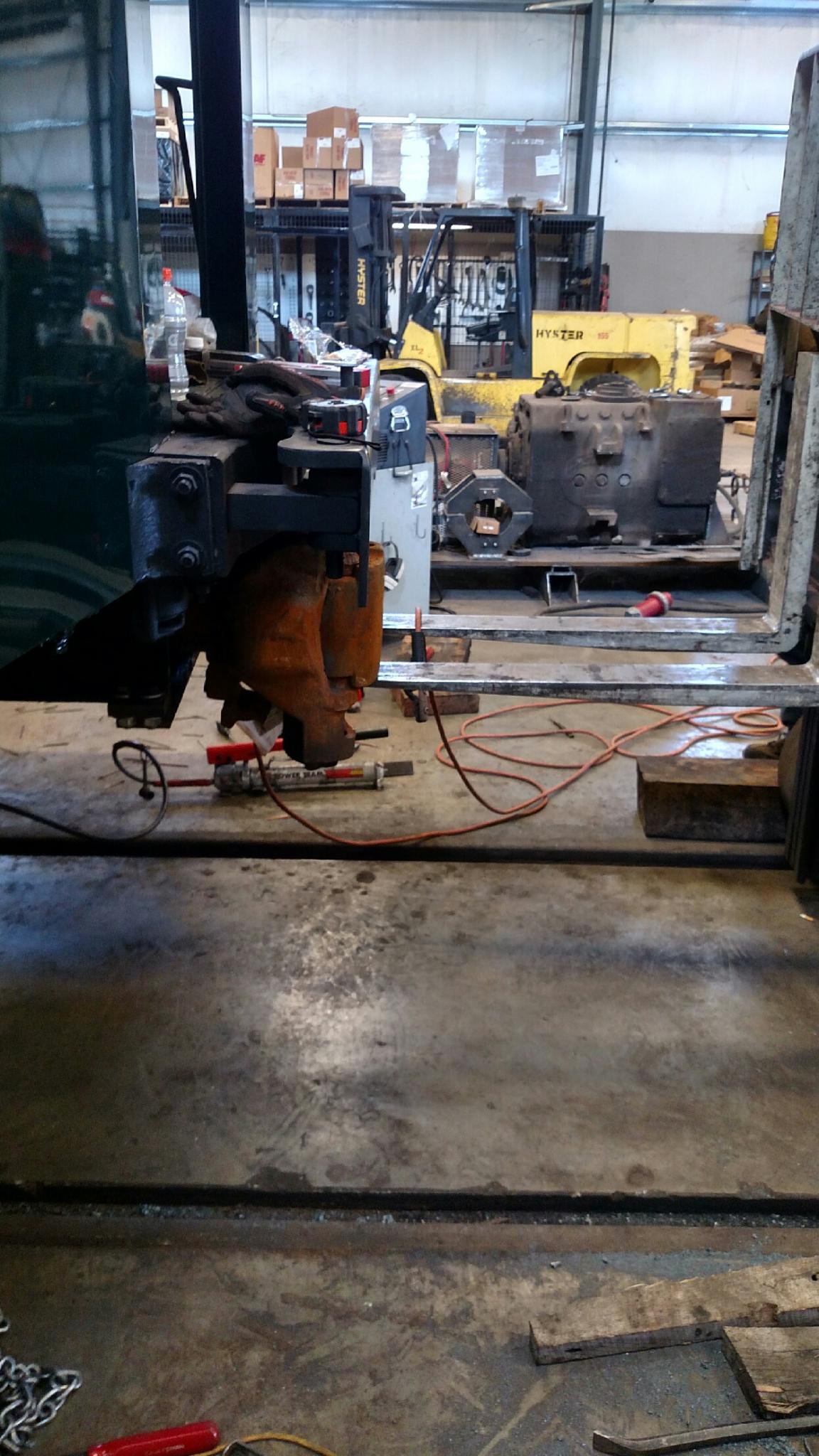

We have just completed the installation of new couplers in old pockets that once carried Sharon couplers.
This installation actually requires a few new changes to the original frame and original pocket or carriers. These new adaptations include new buff/draft cushioning devices as well as new couplers. The installed couplers shown here are from Columbia Steel Castings.
This is one of many new or modern adaptations Wasatch is making to passenger cars. I will be posting another thread that shows a variety of work we have been doing to help modernize old passenger cars.
