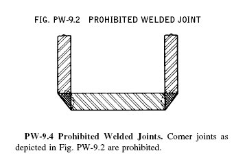

Overmod wrote:
It might be worth $415 just to find out the details of the 'final stand' the committee and the ASME took on fillet-welded staybolt practice...
Regardless of desires of some on the PL Subgroup, PW Subgroup prohibits weld corner joints that subject the root of a weld to bending stresses. PW Subgroup will have to amend PW-9.4 to say "...prohibited, except for the installation of fillet welded staybolts per Part PL."

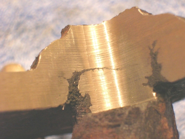

A broken fillet welded staybolt stub end is equivalent to fillet welding a 1" diameter by 3/8" thick slug over a 1" diameter hole in the boiler sheet. That is AFTER the fillet welded staybolt is broken. Before the fillet welded staybolt is broken, the corner joint bending stresses are exacerbated by the tension stresses of staybolt. This is a photo of the failure mode in action, linked from a previous post {click here} by Mark Jordan in 2010.
