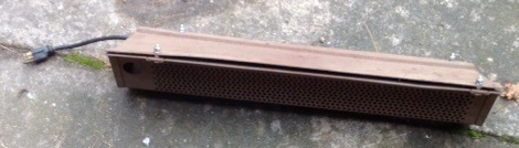

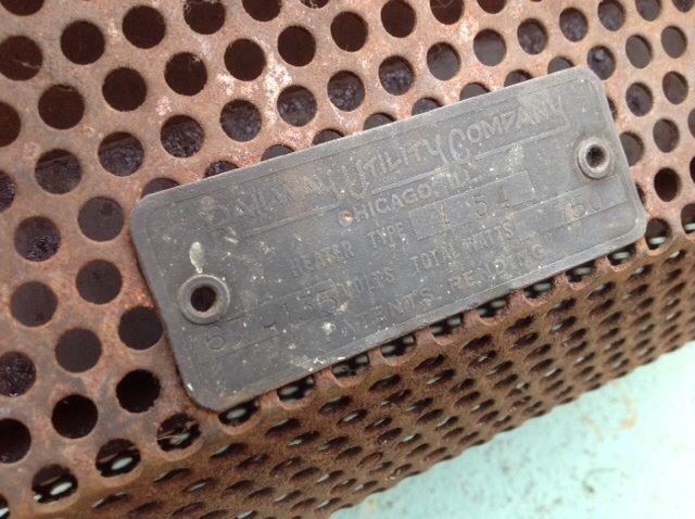

I was cleaning up the shop and decided the best way to get rid of some electric heaters was to reinstall them in the car. (Chicago South Shore car #1 with later walkover bench seats). Here is a picture of one of them, and a close-up of the builder's plate.
File comment: Railway Utility Co heater

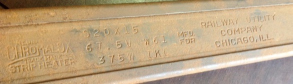

File comment: Railway Utility Co builder plate
Now, these are simple units. Railway Utility Co. only makes the enclosure. They contain two heater elements within. Here is one heater element and a close-up of the stamping.
(Next message)
I am tickled pink to learn Chromalox is alive and well, and still catalogs this series of heater, with identical form factor, though not with these exact electrical specs. http://www.chromalox.com/productcatalog ... spx?m=3530
These heater elements are 375 watts each and entirely sealed inside a steel can, whose exterior is of course rusted after these many years, but not severely. Notice they are 67.5 volt units. It seems the Railway Utility Co. leaves it to you whether to wire the elements in series or parallel, ours are series. This gives a 135 volt package giving 750 watts at that voltage.
Sharpen the pencil... Watt's Law says at 67.5 volts, you get 375 watts at 5.5555 amps. Plug that into Ohm's Law and the resistance of each element should be 12.16 ohms. Indeed, every unit tested at exactly that. It also tested infinity across insulators, or worst case 5 megohms if the insulator was dirty.
You may notice the AC power plug on the top photo. Yes, I applied 120vac. Each enclosure contains two elements in series (24 ohms). Ohm's Law says applying 120vac should flow 5 amps... And Watt's Law says that'll give 600 watts, well within the unit's 135 volt, 750 watt rating. I ran one for an hour, and it made lovely heat without any parts getting frighteningly hot.
So does anyone else have units like this on their electric cars? Do you energize them for car heat? I am turning a thought toward wiring two enclosures in series to run on 240vac. This would allow us to preheat the car using shore power.

File comment: Chromalox heater element
File comment: Chromalox stamping

Robert, I am all in favor of reusing old historic equipment, but there have been some safety improvements made in the years since those were manufactured.
Most modern electrical heaters (bought at the home improvement "big box" stores) now include a "thermal cutout". This device is added so in the unlikely event the heater gets too warm the electrical power is "cutout". They are meant for situations where furniture, drapes, rugs, etc. block the flow of heat away from the heater. This can cause things to overheat and possibly start a fire.
I would like to suggest that you purchase a few inexpensive modern units (tens of dollars) and reuse the thermal cutout from them inside your historic units. It's a little (approx 1" diameter) can with a copper capillary tube that gets installed along the interior of the heater enclosure. They are simply wired in series with the heater and "open" the circuit if things get too warm.
Also, it might be a good idea to use a mega-ohmmeter to check the quality of the insulation on those units. Age is an enemy of insulation, it would be a shame if something arced over while inside a historic car.
Safest thing might be to get a modern unit and use the "guts" to modernize the "inside" of your historic units. They could still look like "period" units, but be up to date safety wise. Or, if you are only interested in cheap, safe heat just buy some modern units ?
Granted electric heaters are quite safe, but I doubt the original designers had access to modern insulators and thermal protection devices.
Just a few safety thoughts. Reusing very old electrical wiring/devices gives me pause for concern, especially 120/240 volt stuff. It does not seem like "high voltage" but it can still start a dandy fire.
While remodeling my residence I found a flush ceiling light fixture (with a burnt off "Maximum light bulb: 60 watts" label), the wiring was charred back from the fixture about a foot. Somebody had put in a 100 watt bulb sometime in the past. It was a house fire waiting to happen and I only found it because of the remodeling project. Modern light fixtures installed in insulated ceilings also include a thermal cutout device.
Cheers, Kevin.

Modern foreign stuff is cheaply built and light on materials for both resource and transportation reasons. It's designed to run hot and hard, with early failure a foregone conclusion. For instance in a Chinese heaterfan, if the fan fails the heater instantly overheats. The thermal protection is more to protect you from this design philosophy, and was not mandated until this cheap junk started washing up on our shores.
With these Railway Utility Co. heaters, I was struck by the quality of the build. The sturdy case was no surprise, but I was expecting the usual streetcar era stuff, exposed wire wrapped around cast ceramic cores. Here's what they actually are.
http://www.chromalox.com/catalog/resour ... eaters.pdf
For conduction to air, Chromalox rates this package at 8 watts per square inch, RUCo. specced it for 5 and we'd do 4. The assembly is a large unit (3 feet long) at only 750 watts. It's clear the strategy is radical overdesign: large unit, low heat output, lots of thermal conductivity, lots of surface area and tip top quality. The caging is quite good too. We haven't seen appreciable evidence of stuff falling in and blocking the elements. The units that are untouched show the occasional dust bunny and period gum wrapper which clearly date back to commuter service pre-1982.
I will check with Chromalox but I doubt the efficacy of a thermal cutout since the elements run so much cooler than the "angry chihuahua" heaters they're meant for. But it wouldn't be a problem to add one. I would also add arc-fault breakers. And yes, megger them as part of the cleaning process, though given that they are insulated for 1500, I am not expecting trouble there.
I disagree absolutely with overall stereotype that modern stuff is better, especially given the crash-dive it's taken in product quality. You might doubt 88 year old wiring, but keep in mind this car was built with the very best materials, and everything in it is insulated for 1500vdc, which most modern stuff is not. "Newer" is not necessarily an upgrade. You really have to compare on a case-by-case basis.
These heaters were removed because they physically interfered with a well meaning installation of modern "tenant grade" baseboard heaters, which didn't last 6 months. They were 2400w and weighed 10 pounds, as opposed to these heaters which are 750w and 20 pounds.

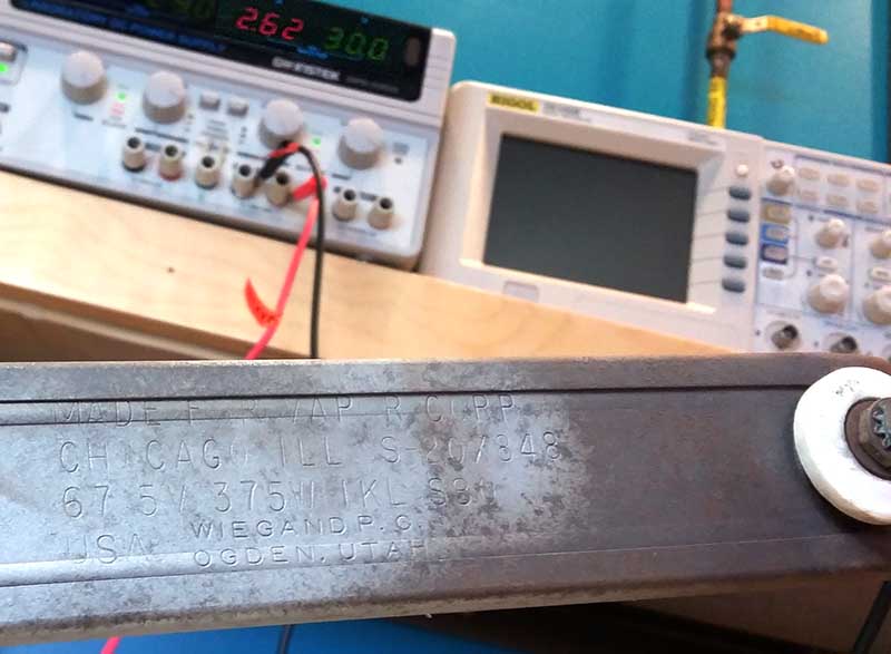

Found a different type of heater in South Shore #36. It's not labeled well and seems largely inferior to the Railway Utility Company. There's nothing on the chassis to say whose it is, but here's an interesting heater element.
It's not a Chromalox heating element, it's a Wiegand. It's a dead ringer for a Chromalox and intermixed with them. Here's the interesting thing. Wiegand is the founder of Chromalox.
The heaters have the exact same values as the ones I documented earlier.
This element is not made for RUCo, it's made for Vapor Corp. (who also made those caboose stoves). That tells us who makes the heater - they have no other distinguishing markings.
Just as the Wiegand elements are dead ringers for Chromalox, the Vapor Corp. heater assemblies are the same fit as the RUCo. heaters, but a different style.

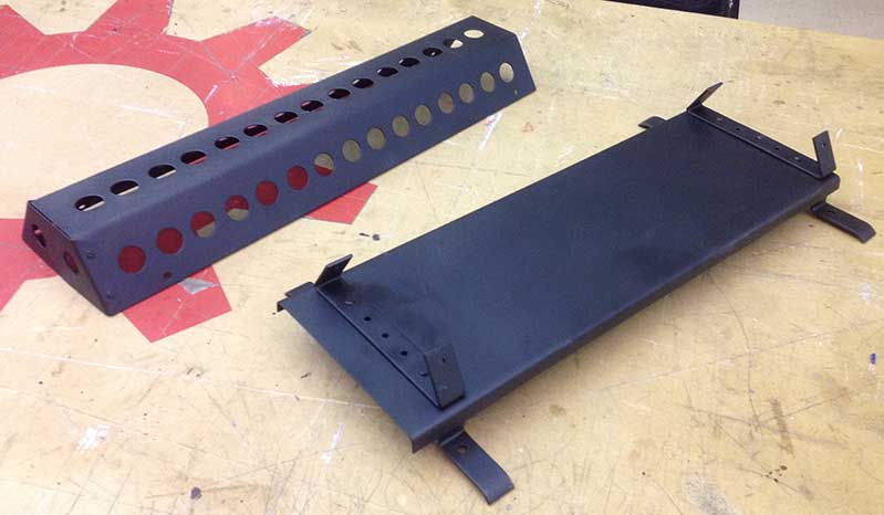

Here is a Vapor heater assembly freshly powdercoated.

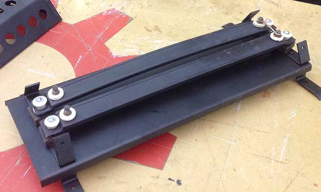

The heating elements installed. The elements proper were not powdercoated but got high-temp BBQ paint. The insulators were masked and carefully cleaned up.

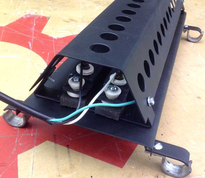

Fully assembled, ready for burn-in. Literally. It takes 20 minutes to burn off that "new heater" smell.
Those white insulators (with the bolts through them) are (still) supplied by Chromalox for applications 480V and up, or in series, or direct heating of air - all three apply here.
The bottom iron seems complicated enough that I wonder if Vapor and RUCo didn't work together or inherit patents and tooling. I went crazy trying to find the J-hooks which clamp to the seat frames. You are seeing an original, turns out they are precisely wall clamps for 1" EMT thinwall tubing, even with the little nub on the end which makes it grab the tubing. It's obvious that this product was engineered to use those.
