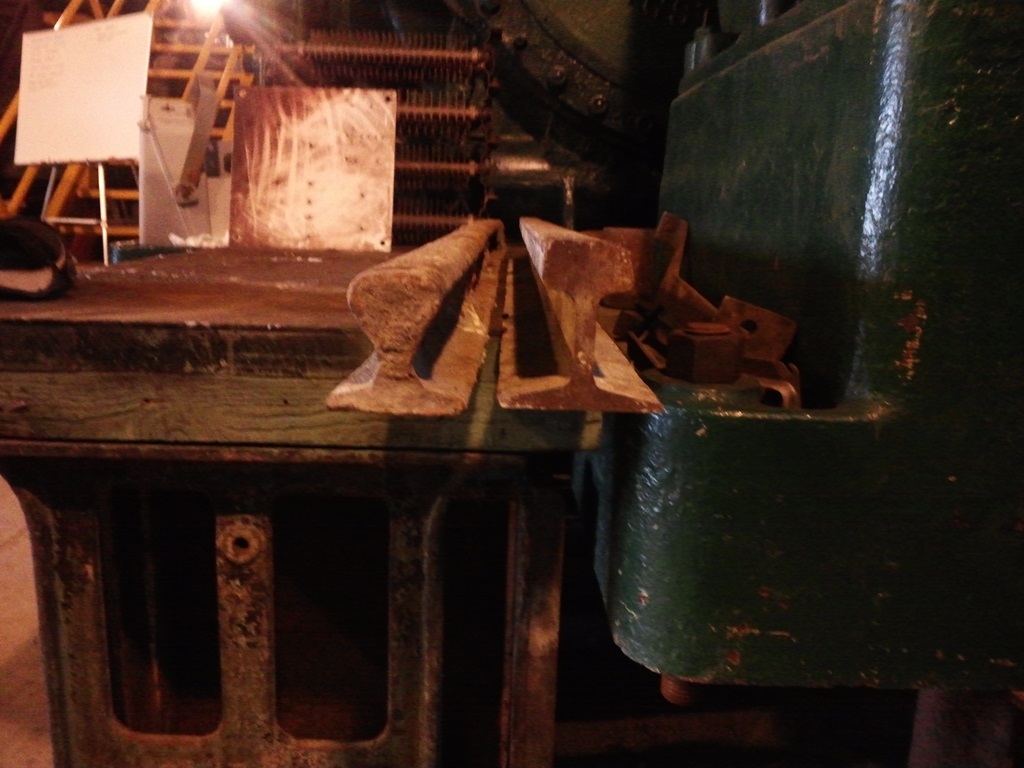

Rails buried in concrete for transfer car tracks in mill buildings have been a fruitful source of old rail for me. A few years ago I found a Cammel Sheffield steel rail rolled in 1881 and marked for the LS&MS in the floor of a mill building in Masury, OH. And just last week I found a section of wrought iron pear rail that had been buried in what was the American Steel & Wire Co. plant between the Carrie Furnaces hot metal bridge and the Rankin Bridge.
That piece of pear rail has me baffled, and I am wondering when did pear rail go out of style. I am thinking that it must have been rolled in the 1860s or 1870s at the latest as steel rails were rapidly supplanting iron by then. In the photo the left rail is the pear rail and the right one is the 1881 "Cammel Sheffield Toughened Steel 1881 LS&MSRY" rail.

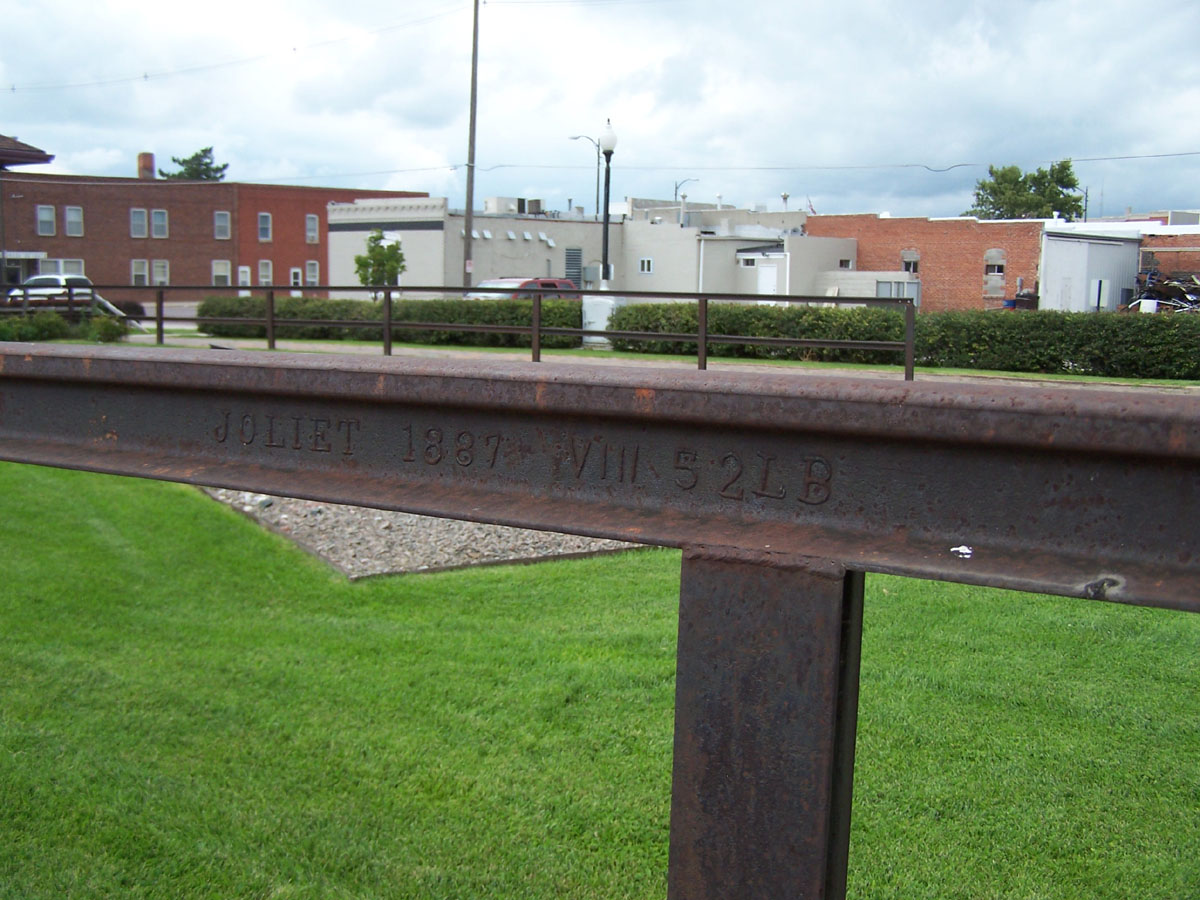

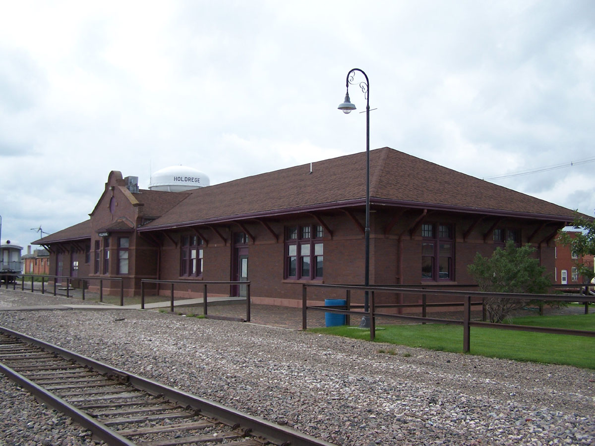

During our drive to Colorado Springs for the 2008 ARM conference, our group stopped off at Holdredge, Nebraska to visit the ex-CB&Q depot there. As shown in the general photo of the depot, the railing is made of old T-rail: Joliet 1887 52 lb. I took a close-up of the markings on the web of a section of the rail. This must have been put down when Native Americans were still about and the Burlington's standard power was 4-4-0s. While not being used as it was intended, this rail still serves the railroad in another capacity.
Holdredge is a stop for Amtrak's California Zephyr. There is also a caboose and a couple of pieces of track maintenance cars on display just to the east of the depot and at the time a heavyweight obs or PV to the west.
Thanks!

Jim Vaitkunas wrote:
...As shown in the general photo of the depot, the railing is made of old T-rail: Joliet 1887 52 lb. I took a close-up of the markings on the web of a section of the rail. This must have been put down when Native Americans were still about and the Burlington's standard power was 4-4-0s. While not being used as it was intended, this rail still serves the railroad in another capacity.
I dare say that rail has fared better than the mill that rolled it:
Thanks!
Jim -
Thanks for posting the photo of the section of 52# rail made at Joliet in 1887. The "VIII" after the year probably means it was rolled in the 8th month, or August, of that year. This is the first I have seen of the Roman numerals used to indicate the month rolled. The rail sections I have seen would just have had 8 I's ("IIIIIIII") to indicate the eighth month. I wonder if this indication was peculiar to Joliet or if other producers once used the Roman system.
BTW, Joliet Iron Works eventually became part of American Steel & Wire and eventually fell under the control of U.S. Steel where it was known as USS-Joliet. I don't know how long Joliet actually rolled rail, but at the end of their existence they were making wire products including nails, barbed wire, steel fence posts, etc.

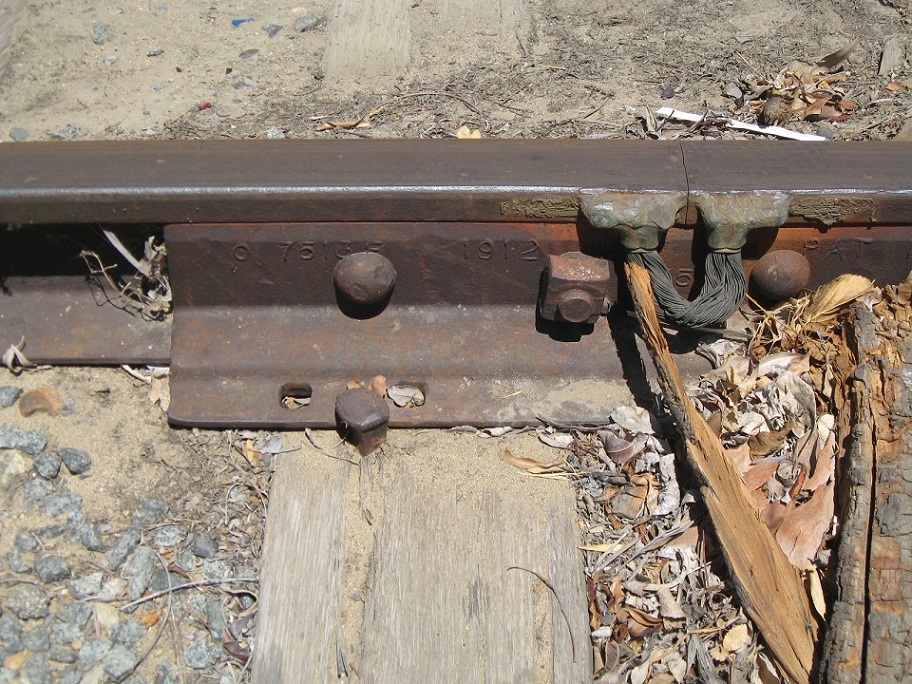

Posts: 1025
Here's some 100 year old steel still in service. It's on a remnant of the Pacific Electric San Bernardino Line in Rialto CA. There's also some 1906 Carnegie 70 or 75 lb. rail at the tail end of the PE remnant in Azusa.

Here's another example of rail that had a long life. While chasing the Wellsville Addison & Galeton RR in the 1960-70s I found that every stick of rail I had occasion to check was from the 1893 original construction of the line. Most of it showed little sign of wear, suggesting that traffic on the line had always been light. The rail was still being trodden upon by WAG's 132 ton GE centercabs and the successor F7s. I never heard of any rail breakage problems in talks with WAG personnel. Must have been good stuff to begin with.
