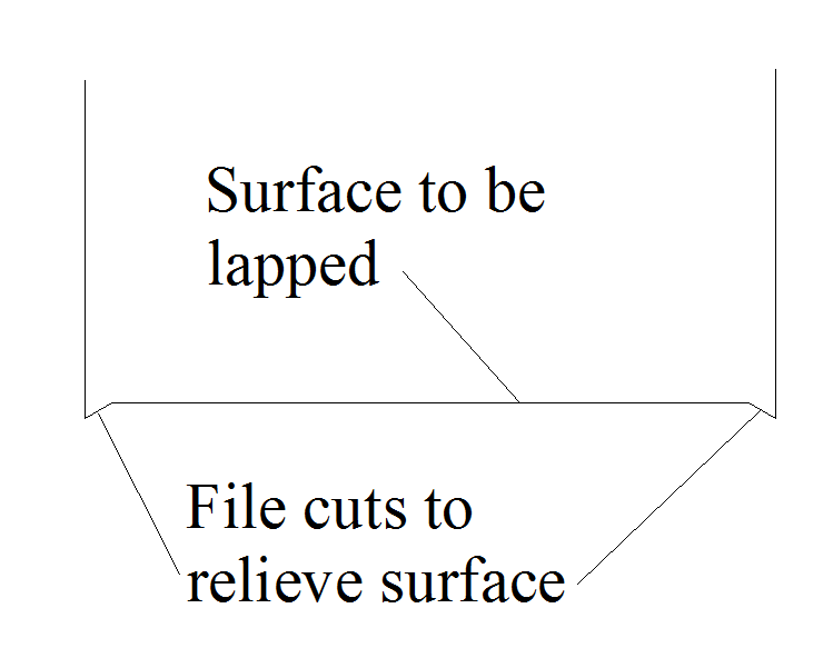

First take a small triangular file and relieve the corners of the surface to be lapped in the body so the block won't ride up. (Figure File cuts)
You need a lapping block that fits the body. Make your lap from cast iron and diagonally score the face. Figure out how to hold on to it. I machined a spherical seat into the top, hard soldered a ball bearing that fit the seat to a worn out screw driver and put a 90 degree bend in the screw driver. (Figure Driver and lap)
Using a fine lapping compound lap the body seat with the cast iron lap. Then lap the slide to the cast iron lap, then lap the slide to the body and repeat until all three surfaces are flat. Finish with an extra fine compound.
Clean everything scrupulously. Good luck!
CCdW

able to get the flat down. You'd also have to make an optical flat that is ground to the precise dimension
so that it fits into the slide valve chamber.
A toolroom grade granite or steel surface plate makes an excellent reference surface for lapping the
slide valve and the lap. As I said before, I prefer abrasive paper because it does not wear down
the reference surface. You'll generally get the brass slide valve done with one sheet of coarse
wet-n-dry SiC abrasive paper, about a 200 grit, followed by one sheet of 400-600 grit. Finish with
a 1000-1200 grit if mirror finish makes your happy. Skip the coarse pass if the valve is only slightly
out of true and there isn't that much metal to remove.
Doing the seat is much more tedious. The hardest part is holding the paper to the lap. I've experiemented
with a number of approaches. Sticky tape can work -- anchor the strip of paper to the top side of
the lap, pull it around fairly taut and then stick it down on the other end. If you are using cutting oil,
which is helpful when working at the coarser grades, it quickly impedes the tape's stickiness. Another
approach is to mill a couple of slots on the top of the lap, get two little strips of metal, drill and tap
so the strip can be dropped into the slot and held down with a thumbscrew. You'll also need a precise
paper trimmer to make strips of paper that are exactly as wide as the lap: too wide and they'll curl
and bind on the sides, too narrow and they may not cover the entire seat surface.
The paper will load up much faster when working the seat this way vs working the valve against the
surface plate. I often pull the lap out every 10 strokes or so and blow down the paper and the seat
with an air nozzle.
There is an investment in time making the lap. Protect it. Don't ever stamp the lap to ID it. Light
scribing is acceptable, or paint marker on the top. Keep it in a cardboard box when not in use.
Record the critical dimensions and the valve or valves that it is intended for and also write this
information on the box.
Always interested in other's experiences with this tedious task.
