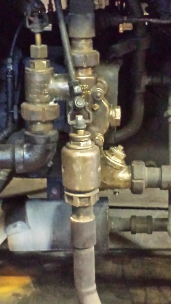

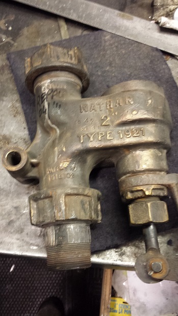

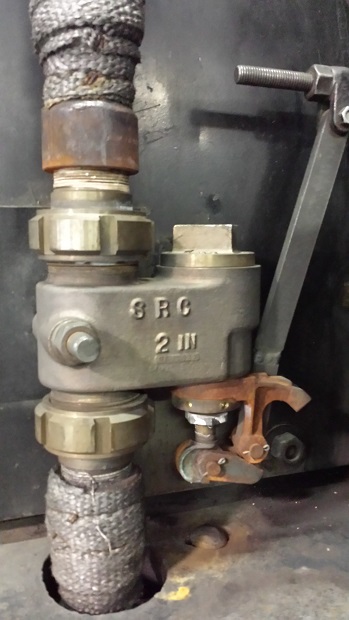

In my opinion it depends on the service you are using it for. If your on a short, stop and go road engine, the Simplex would be my choice. Although I haven't used the Monitor, it looks like you can feather the feed back to suit the usage, better for a long haul engine, but the Simplex is either on or off, like a Penberthy injector. The only issue I have had with them in the past 15 years isn't with the injector but the starting valve. They are made of cast brass and over the years of use the bodies and seats have cracked. I tried fixing them but ended up reto- fitting a Sellers replacement from Strasburg RR. Should have done it sooner as they work flawlessly and just regular PM in the Fall. We also have a NOS steam nozzle and combining tube for the #10 Nathan Simplex (mud sucker :-)
Brian Manning CE/CMO
Heritage Park

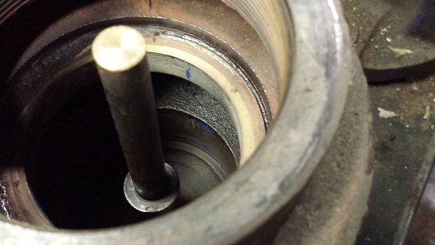

Nathan starting valve cracked seat in 3 different places, although hard to find, dye pen will find it easily.
