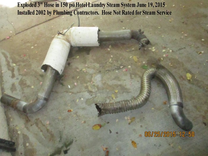

There are many different styles of SS braided hoses. One should always READ the specifications.

Hope this discussion takes off some more. I know in other areas of industry they have used couplings that were slightly flexible in high pressure use. I am not a steam fitter or work in that kind of industry anymore. With the poor condition and cost of casting steam delivery pipes have always wondered if used in the connections if that might simplify replacement in this kind of use? Of course we have seen some fabricated delivery pipes made and if I recall, hear they work fine? As rebuilds go further and further into having to replace worn castings would this type of flexible fitting be of any use? I am thinking more of small flexible fittings to use almost as unions rather than long runs. Maybe just finding the right shop to fab the delivery pipes is the way to go? Just wondering out loud, not purporting that it is the way of the future.
The picture of the burst steam pipe from hotel laundry is scary. The people working in laundry would not know what hit them if they were near by.

The hose only failed after 13 years in service. If you put a hose in service like that, it would seem prudent to replace it periodically. You can't leave it in there forever...it will fail sooner or later, no matter what the rating is.

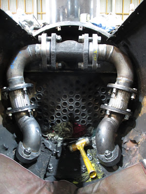

This is what the Puffing Billy did when using the flexible piece. I suspect they would change it at some standardized interval. Notice it is not the entire piece, but just a small part.

The Na class are small locomotives doing a big job in daily revenue service. Few of us work ours so hard and often..... the useful life of this alteration will let itself be known in due course - I hope it lasts long enough to be a cost effective problem solver.

Regarding the exploded hose, only by luck were there no dead bodies.
