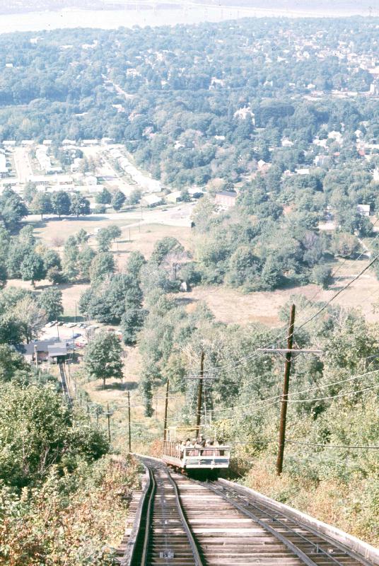

If the Mt. Beacon Incline Railway ever gets rebuilt, that would be another draw for Beacon. I was fortunate enough to ride it in the early 70s.
Roger Cole
