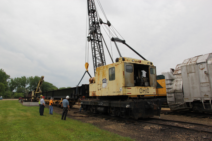

Job Briefing: L to R: John Brazil, Rigger/ Helper; Andy Chmuar, Rigger/Helper; Dan Fenlaciki, Wrecker Operator; Jerry Lynn, Signal Passer/Rigger; Terry Glenn (retired), UP Ohio Crane Operator, former operator of our Ohio when owned by CNW/UP. Dennis Powell (retired), CNW/UP mechanic. Dennis set up our Ohio and her 5 sisters when CNW purchased them in 1976. Mark Secco (retired), CNW/ UP crane operator. Not pictured: Rick Clayton (retired), CNW/UP also ran our Ohio crane while employed. Bob Olson, Fork Truck Driver/Rigger; Dave Diamond, Buildings and Grounds Manager IRM, Helper/Rigger/ Gawker.

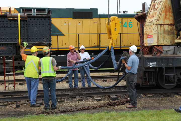

Setting up for basket hitch. Polyester round sling good for 80,000 lbs. Turntable weight, 120,000 lbs.

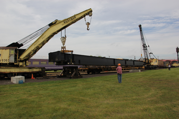

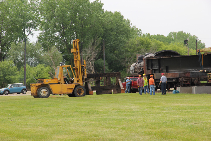

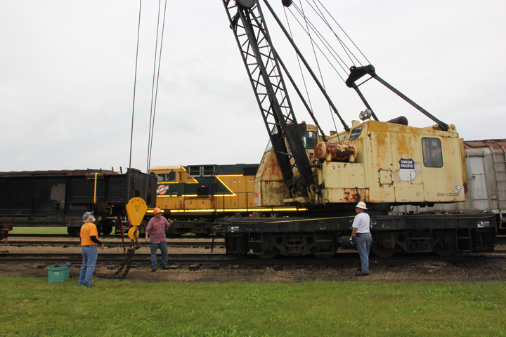

40 ton Ohio ready.

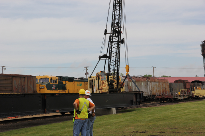

160 ton wrecker using polyester sling with lifting beam.

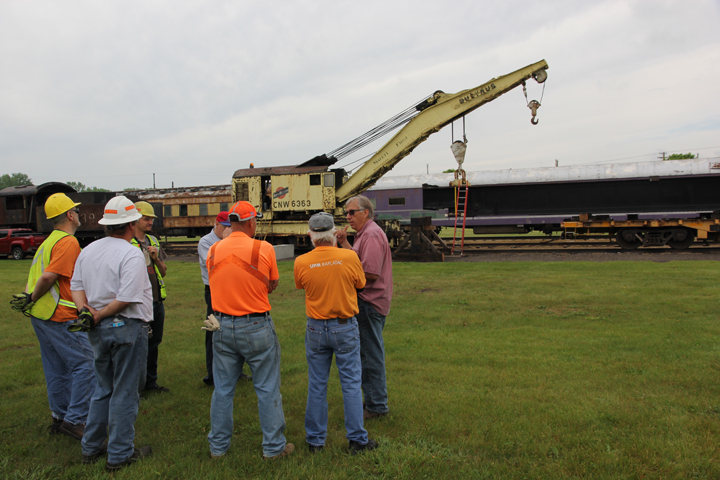

Ohio travels forward 30 feet while wrecker swings.

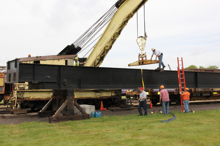

Wrecker re-hooks 30' from end, while table rests on custom made false bent. Ohio's end is resting on flat car. This will reduce the Ohio's load by 11,000 lbs allowing Ohio to safely swing load onto landing blocks.

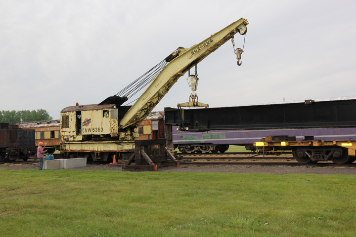

Fork lift takes away bent.
