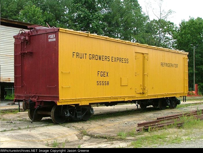

Does anyone know where I could find color codes for a Fruit Growers Express wood reefer? I'd like to replicate the simplified, and slightly darker shade used after the 1940s. I found this example at the Southeastern Railway Museum, they recently repainted their FGE car.
File comment: FGEX 55558 at Southeastern Railway Museum, Duluth, Ga.

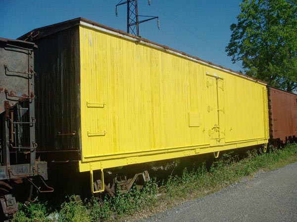

Last year, a gang of volunteers applied primer and yellow paint to the east side of our FGEX 50220. The color is a little too bright ("English Daisy") and since we're getting ready to do some work to the other side of the car, I figured lets get the color closer.
File comment: FGEX 50220 at R&GVRRM
Does anyone have information on FGE red and yellow colors?

Based on what I've seen, the more detailed paint job with black hardware dates from the pre-war era. This FGE car at the California State Railroad Museum reflects the earlier paint job:
https://www.flickr.com/photos/ottomatic77/5936057550/
From what I understand, after the war, FGE went to simplified paint job and lettering without black accents. While the black hinges and grabs "look cool," I think we want to represent a later era with our car.
See also:
http://pennsyrr.com/index.php/data/92-o ... rs-express
And also:
Shamelessly plagiarized from the instructions for Martin Loftin's beautiful and accurate FGEX 40' reefer (Sunshine Models, Box 4997, Springfield, MO 65808-4997):
Paint schemes applied to FGEX cars in the late steam era had yellow sides; red ends, kick board and roof; and black underframe, side sill, trucks, hinges, ladders and grabs. In the late forties or early fifties, grabs, ladders and latches became the color of the underlying carbody--yellow on the sides and red on the ends. The sidesills were briefly red. I believe the cars eventually became yelow on the sidesills, ends and end details also. The yellow was a reefer yellow when new, but in the late steam era, this didn't last long. Sunshine recommends a Santa Fe Warbonnet Yellow or a mixture of 10 parts yellow, one part orange and a "touch" of brown. If you model ten cars and they are ten different yellows, that would not be unprototypical!
-otto-

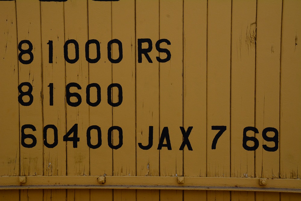

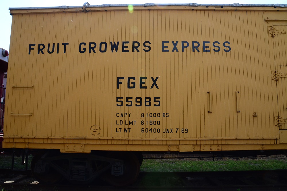

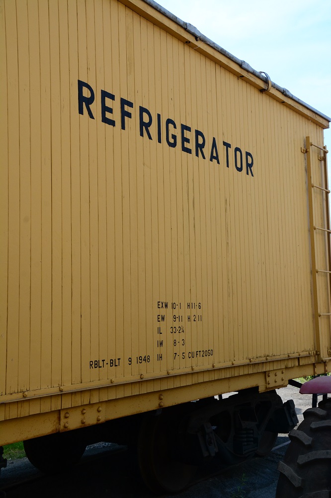

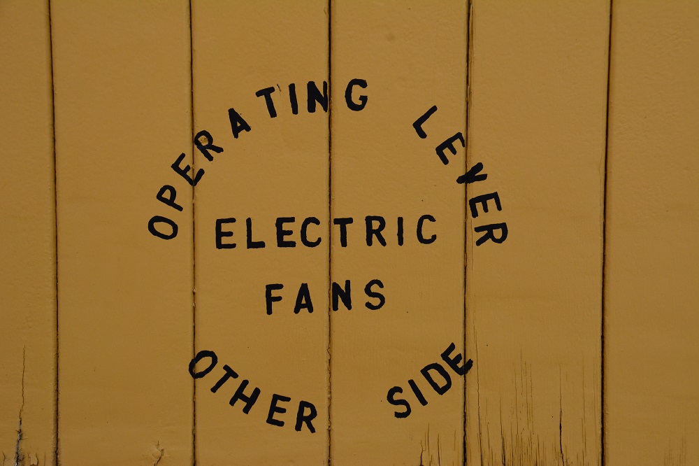

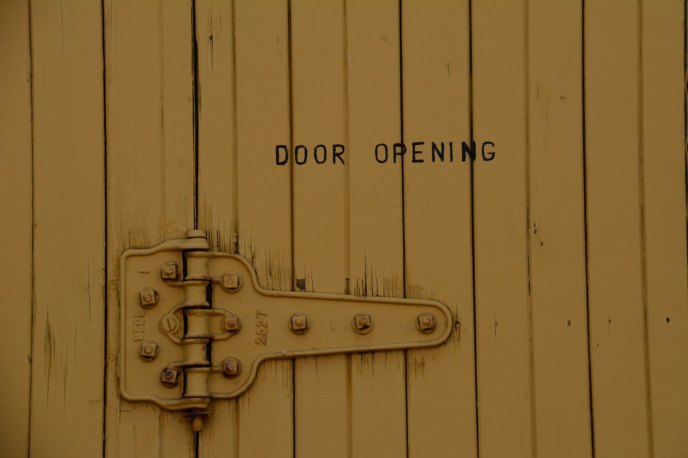

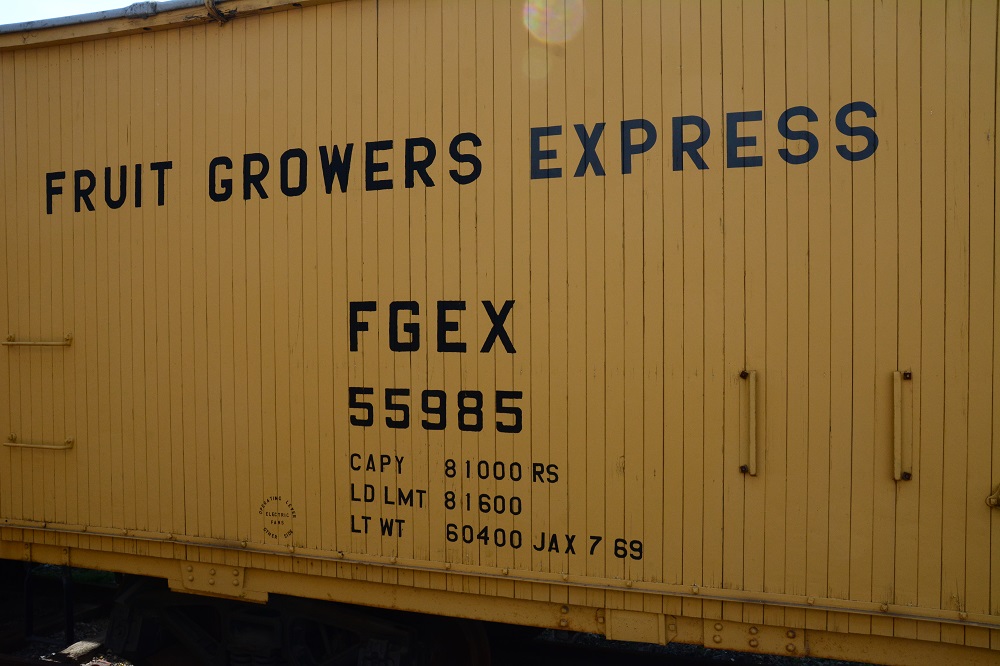

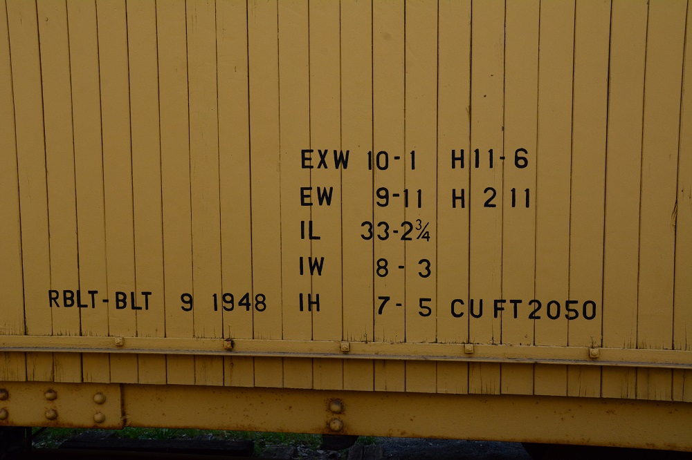

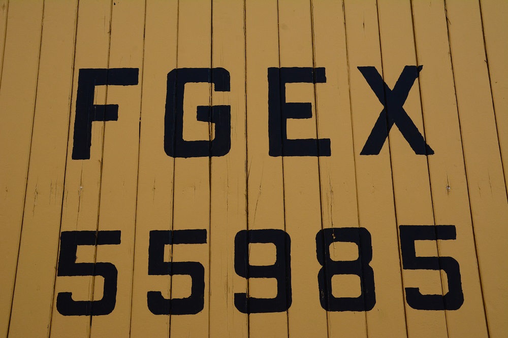

These are some pictures of the FGE car at Midwest Railway Preservation Society in Cleveland, Ohio. We hope this aides other people in restoring similar cars.
File comment: Left Side
 Post subject: Re: Color codes for FGE wood reefer
PostPosted: Sat Jun 11, 2016 5:00 pm
Joined: Mon Feb 23, 2015 8:24 am
Posts: 75
Location: Cleveland, OH
Pictures 4-6
PostPosted: Sat Jun 11, 2016 5:01 pm
Posts: 75
Pictures 7-9
File comment: Right side

This is not original paint, it was repainted some time recently. We did make an effort to duplicate the lettering on it and I am posting the photos of that so the other groups that have cars can do that also if they want to. This lettering was done by a sign painter who used a small brush along with a stencil pattern. The tongue and groove wood siding makes it impossible to just use a stencil and spray can because each groove will have paint running down into it.
In photo number 7 I am not sure what the difference is between EX W 10-1 and EW 9-11 and also H 11-1 and H 211. I think that H 211 may be a mistake and it might be H 12-1.Where EX W 10-1 would be external width 10 feet 1 inch, what is EW 9-11? And why the two H numbers? The other length, height and width numbers are easily understood.
PostPosted: Sun Jun 12, 2016 1:34 pm
I thought I just answered this a couple months ago in a different discussion, but here it is again. EXW is the EXTREME WIDTH, and the H on the same line is the HEIGHT above the rail to where the extreme width is located; in this case it appears to be at the top of the door, likely the top door locking bracket. EW is the EXTERIOR WIDTH, measured at the eaves, and the H on that like is the HEIGHT to the eaves... the stenciling is missing a 1, it should be 12-11. The three lower lines are the interior dimensions; the IL is so short because it is between the ice bunkers.
