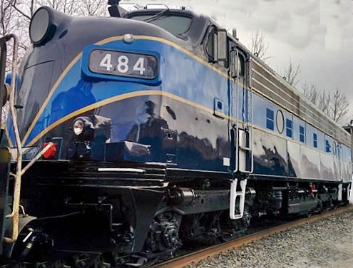

Just wondering if any AAR type B's have ever been fitted to F units?
If not AAR type B's then how about hi-ad trucks from either EMD or GE? Or flexicoil trucks?

Why, Because I have seen many Alco FA units on these GSC trucks and thought maybe somehow a F unit might have received a set of GSC trucks.
There is a 2 axle Flexicoil on a FL9 in Canada. I also saw a TO post about a BN F unit on the GSC or AAR B trucks. The loco being at a scrapper and most likely gave up its EMD trucks for some rebuild or reuse order.
