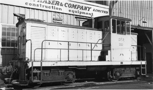

Don't know if this one still survives or not (not to mention the steam power that was still there, too!), but I got curious as to what such a unit looked like, and came across these, the only photos I could find:
http://thedieselshop.us/CarbonLimestone.HTML
http://www.trainweb.org/oldtimetrains/p ... cfp300.jpg
Caption information for this second unit:
Canadian Forest Products Ltd. (CANFOR) 300 ex 95 (acq. 10/55) GE 45 ton OCC #13166 10/1941 This unique Off Centre Cab unit was powered by a 340 HP Cooper-Bessemer diesel engine. Used on Vancouver Island at CANFOR's extensive non-common carrier (logging) railway. Shown here at Vancouver equipment dealer. March 1960 David M. More

The second photo is one of the 45 ton model, easily distinguished from the 60 ton by the lack of end platforms.
I was aware of the CanFor 45 tonner. Is it still around?

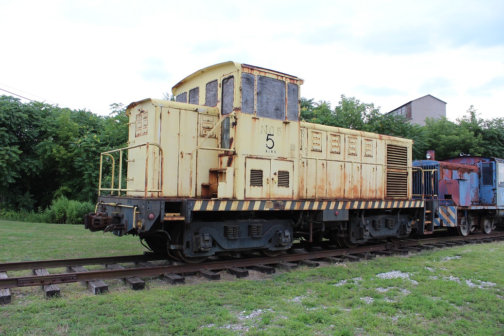

I did not know that the MVRHA's unit was so rare. Its complete, so with a moderate amount of work I think it will run again.
That's something... I know that the New Haven and BAR had some units that looked similar, but I just can't remember if they were GEs or not.

Just as a heads-up, the five I-R and five Cooper-Bessemer New Haven switchers were built for the NH 1936 as class DEY-1 and DEY-2; the five C-B units (DEY-2) were sold to BAR in 1951, the I-R locos to Republic Steel (0906-0909) and Atlantic Coal Co. (0910).
They are NOT the same as these offset cab locos (45 and 60 ton) seen here, built for the military during the Second World War. The NH locos had the radiator in the short hood, and the military ones had the radiator in the long hood as seen on #5 above.
The NH/BAR CB's were 8-cylinder 10 1/2 x 12, and I think the same engines were used in the wartime locos. Maybe Brother Rowlands can confirm by looking in the one at MVRHA?

David, do you have any photos of our unit at ASF? I am sure we will repaint it with ASF lettering since that fits our mission more than it does as an Army unit.
