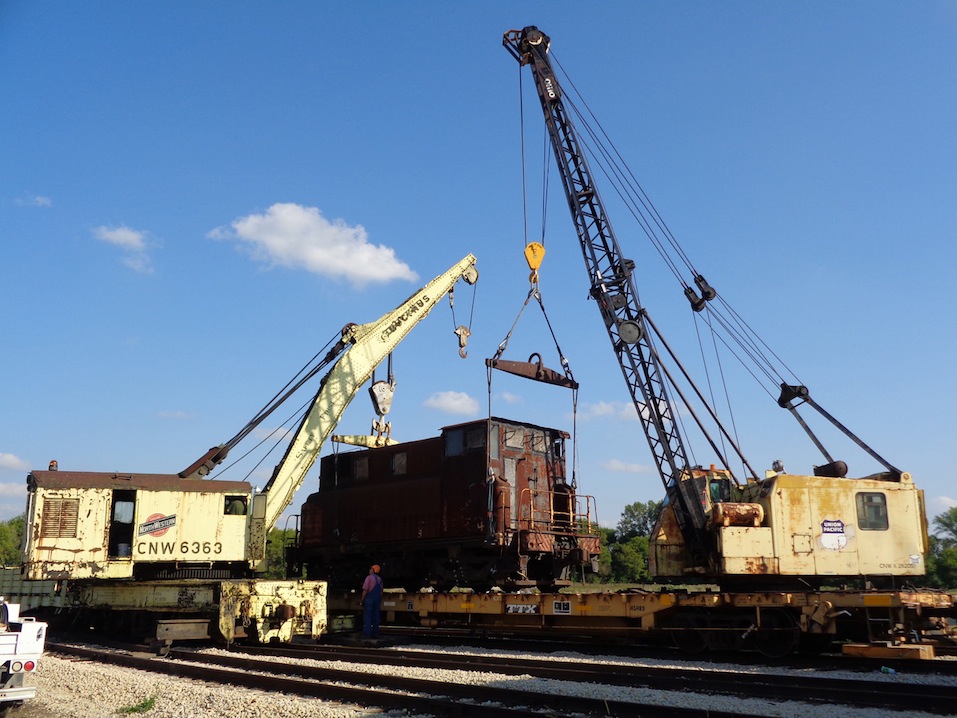

Hey, Kevin Kohls, John T, Charlie and Rick:

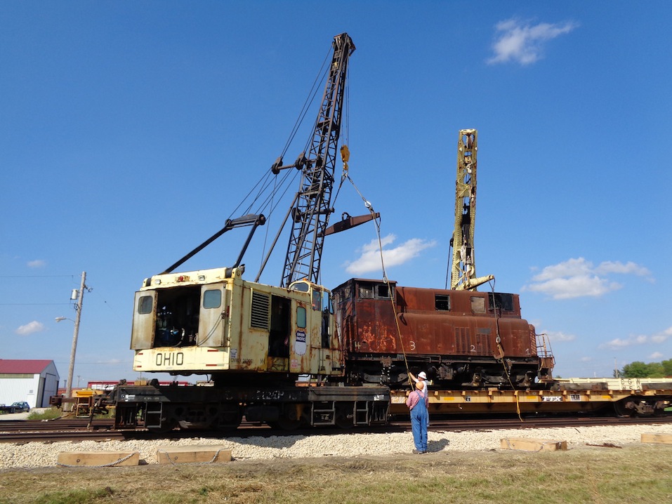

Sorry for the lapse in crane pictures lately but I've been a little busy making outrigger pads, ordering slings, blocking up journal boxes and axles, securing trucks to the car body etc. with our Heavy Lift Group in preparation to unloading the ARMCO B-71. I wore my lucky shirt just in case.

File comment: Andy ,me and Dan setting up rigging.

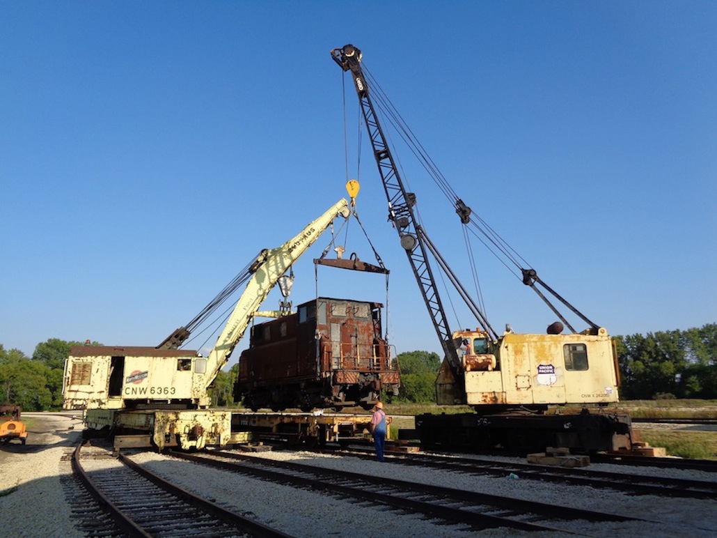

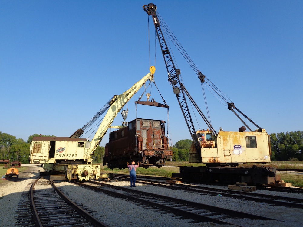

File comment: Terry and I discussing our escape routs.

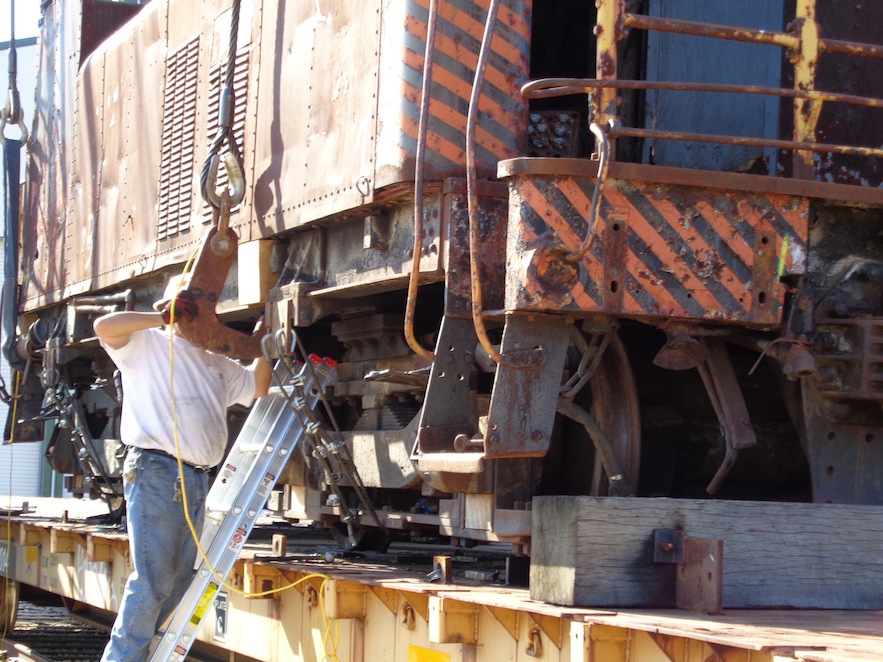

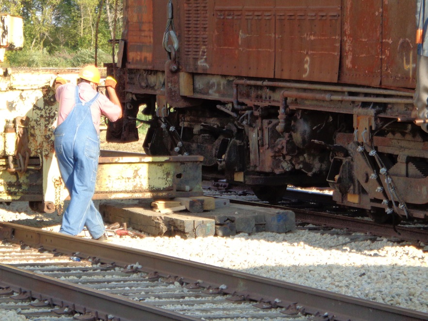

File comment: Andy wrestling sill hook while spreader is on the roof cause we have only 22" before the wrecker's hook block contacts the boom.

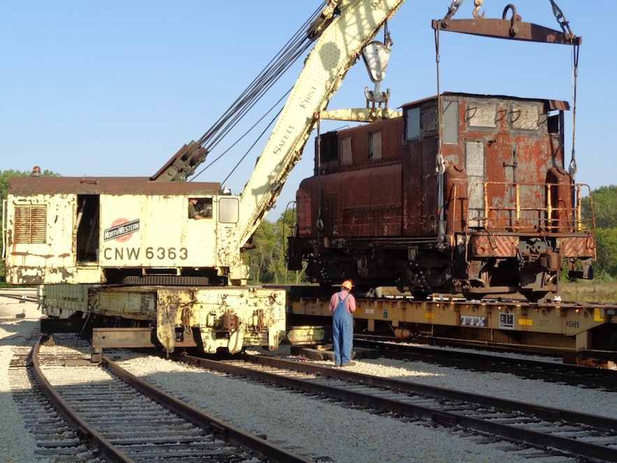

File comment: Wrecker lifting space is almost gone but it's enough.

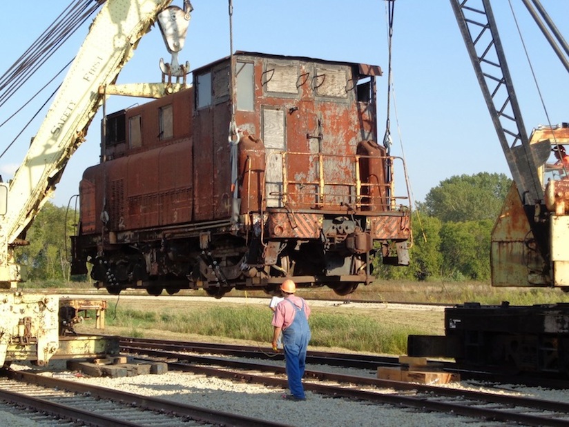

File comment: 7" clear, there goes the flat car.

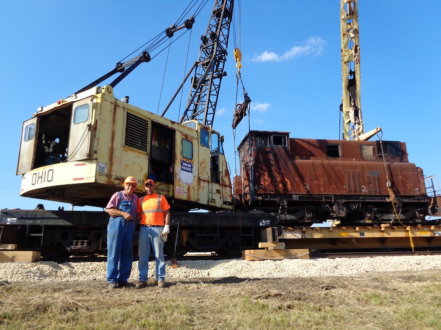

File comment: Touch Down. All but one wheel landed in gauge . That one was off by 3/4" .
