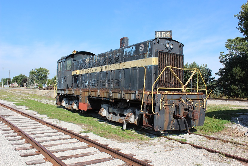

The 864 worked at North Star Steel for several years until the connecting rod bearing failed on the No.1 cylinder, which permanently took it out of service. The 864 was then acquired by the Mad River & NKP Railroad Museum and moved to Bellevue, OH, taking up residency in the museum’s coach yard. The 864 was not considered a part of the museum’s collection since it had no significance to the museum’s mission. It was acquired merely to save a rare locomotive from scrap.
