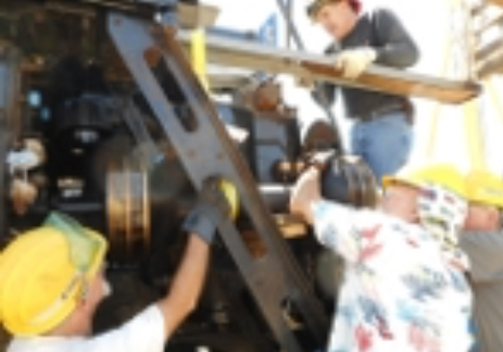

Photos posted recently by the Santa Fe 2926 restoration team in Albuquerque show her
piston valves being reinstalled after many years. This is a major step towards getting her moving under her own power again. See the installation process here
http://www.nmslrhs.org/Photos/2019/08-31/index.html

They just posted photos from 9/7 showing work on preparing the drifting valves for installation. Looks like installing those buggers can be exciting.
 Post subject: Re: 2926 is well on her way to being “buttoned up”
PostPosted: Thu Sep 12, 2019 10:10 am
Posts: 576
Right! Lots of potential energy that wants to become kinetic if not properly managed and contained!
