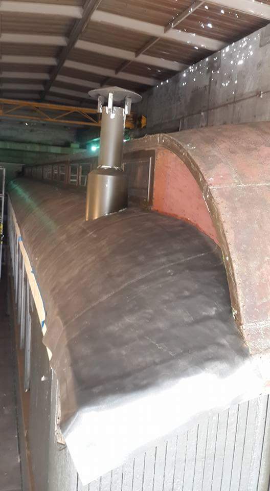

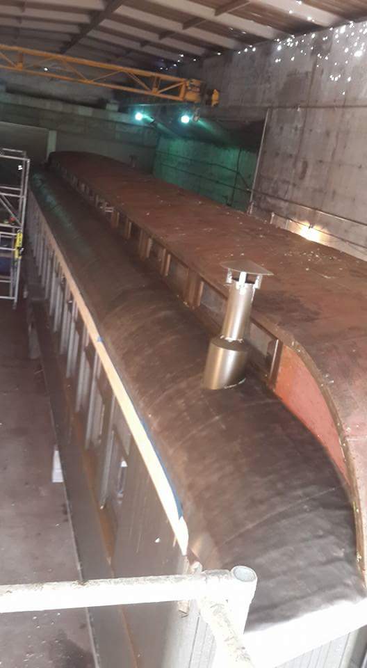

After much prep work we laid the first 50 feet of rubber on car 57s roof today and we're really happy with both the process and the look. The tin roof which we uncovered several years ago was rusted through in many spots and had hundreds of holes every few square feet from roofing nails driven in when it was a house from 1954 to 2008. The roof ends which we thought would be difficult due to the curves took the rubber so well and only required one small cut to ease the creasing....and u can still see all the seams underneath.......4 more 20 ft rolls should see the roof completed. She will be 130 next year and out on show again in Cheyenne.

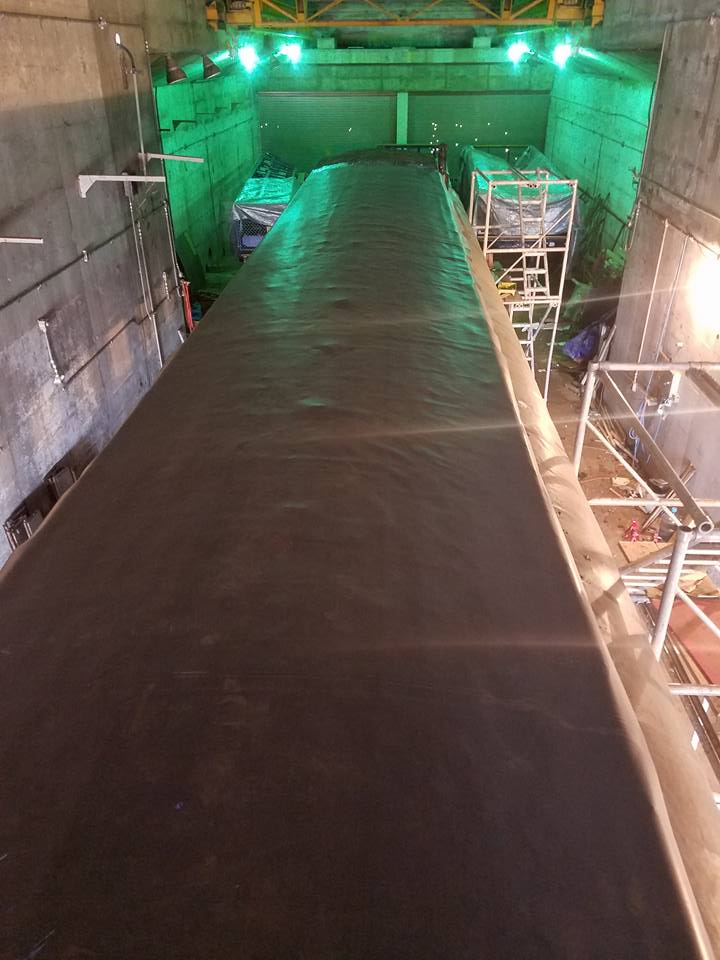

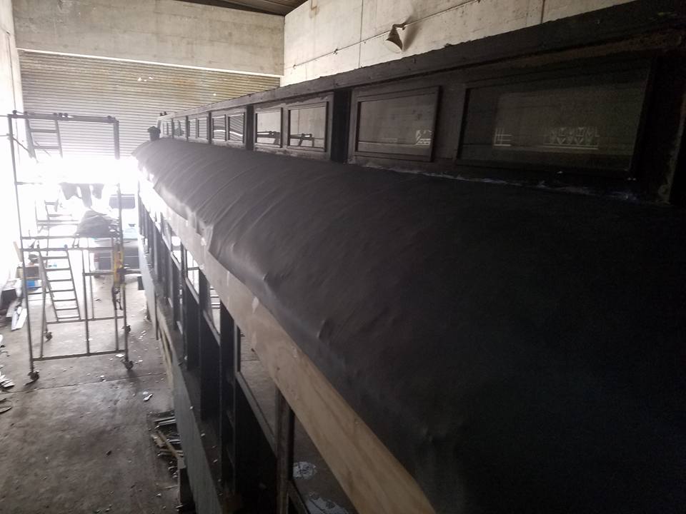

As it was a balmy 52 degrees today we hit the roof hard on 57, next week it will be -52 so we installed 40 feet of side roof and 40ft of main roof membrane.....immensely satisfying day.
Mike Pannell
