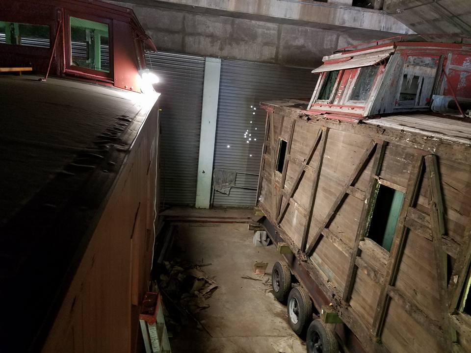

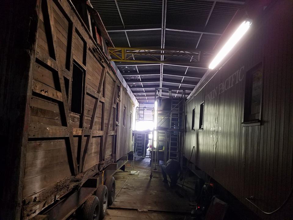

Today we began the long road of restoring this 1907 caboose. Several horrors were found not unexpected tho and will be rectified, it appears the caboose has been dragged sideways at some point with damage to the frame as a result. The cupola is sinking and this is down to the 5 x 3 support being entirely rotted out 9ft of this will be renewed.
We also found that the frame had been shimmed so that the siding went on parallel to it...maybe twisted when constructed or damage sustained later on before re siding.
Mike Pannell
Cheyenne
