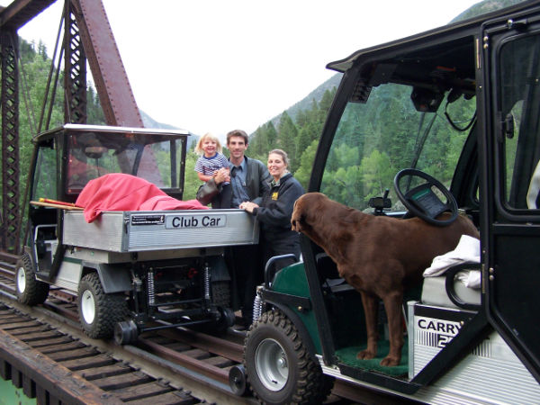

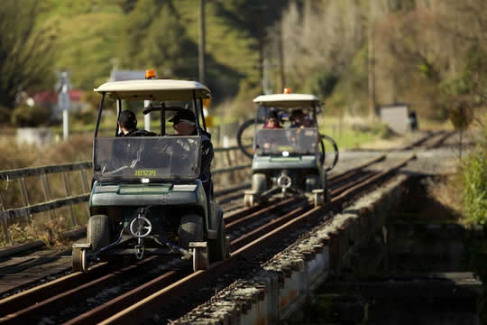

sousakerry wrote:
RCD wrote:
Just use some golf cart innerds.
HAHA funny thing is there is a broken golf cart sitting right behind it in the barn that needs a new controller. Wonder if anyone has ever Hy-railed a golf cart
Not to get really off of topic, but it is funny that you were to say something like that. This link here http://www.golfcartcityonline.com/blog/ ... d-railway/
is a blog that is about a complete golf cart railroad. The Forgotten World is the people who run it and have the 30 year lease for the line, might just be something to look into if you have one of those high capacity golf carts.
