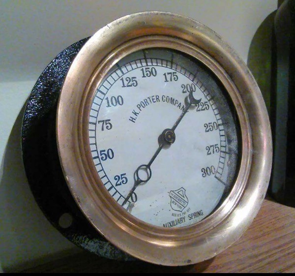

Good Morning Rick,
I don't know if you are still researching the gauge faces, but here is one I ran across. It is about 6.25" to the outside diameter of the brass ring and about 4.625" diameter for the actual gauge portion.
Hopefully the photo will appear properly.

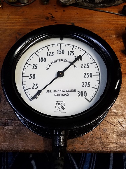

PostPosted: Mon Mar 27, 2017 7:57 am
I found two gauges, took the faces off and had someone print the wording directly to the face. I now have a primary and a spare pressure gauge to use.
