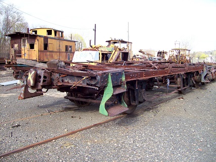

Back in the 2008 time frame, I think it was the Danbury museum that sold off some equipment, including this bobber caboose frame. I think it was said to be PRR. Could this be the one in Schuylkill County, Pa?

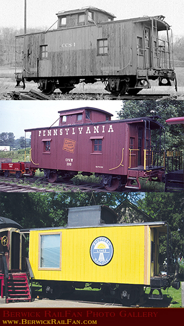

"Unknown # former NDa at Red Caboose Motel, last painted as SP"
This was the one at the Carroll Park and Western RR in the 1960s and 1970s. Went to the Red Caboose Motel in 1979. Arrived at the CP&W around 1958. I'm still looking for info on it prior to 1958 but haven't had much luck.
Top Photo - Bloomsburg CP&W 1958
Middle Photo - Bloomsburg CP&W 1965
Bottom Photo - Red Caboose Motel 2014

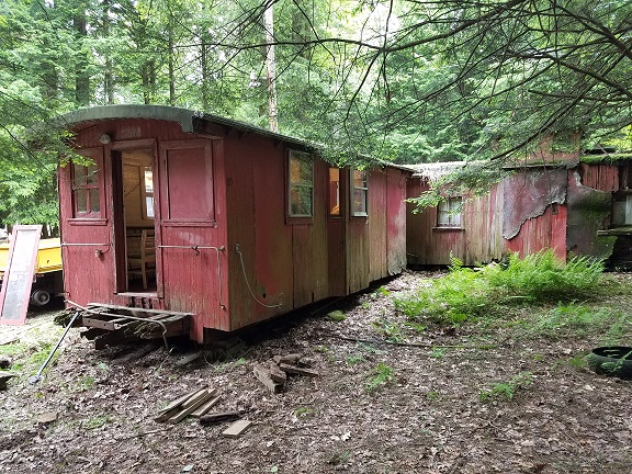

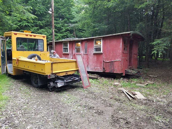

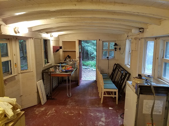

Yesterday work began to move both the PRR ND and the LEF&C caboose bodies from Clarion to new homes. The ND was acquired by Sid Walker and is going to Meadville, PA and the LEF&C car is coming with me to Youngstown Steel Heritage where it will become our yard office/crew room/volunteer bunk car.
The LEF&C 592 is in exceptionally good shape, thanks to a rubber roof that was put on this car at some point. The ND is unfortunately not as good and Sid has his work cut out for him on that project. To get the 592 out of where it is at and onto a Landoll for transport to Youngstown, I will be putting mobile home axles under it and wheeling it out of the woods onto the county road where it can be winched onto a trailer. Once it gets to YSH the axles will make it easy to roll it to its new home adjacent to the J&L Narrow Gauge mainline.
