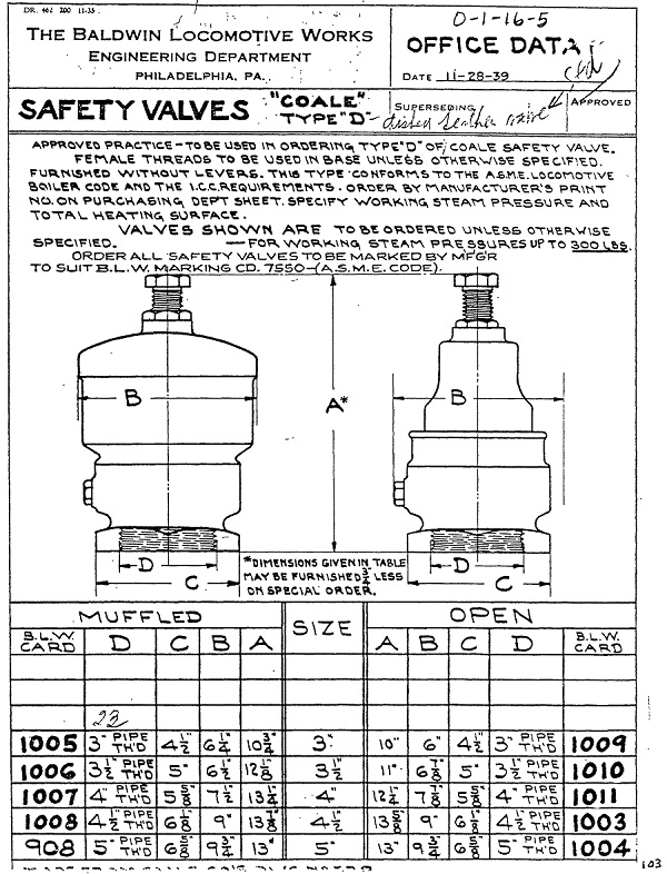

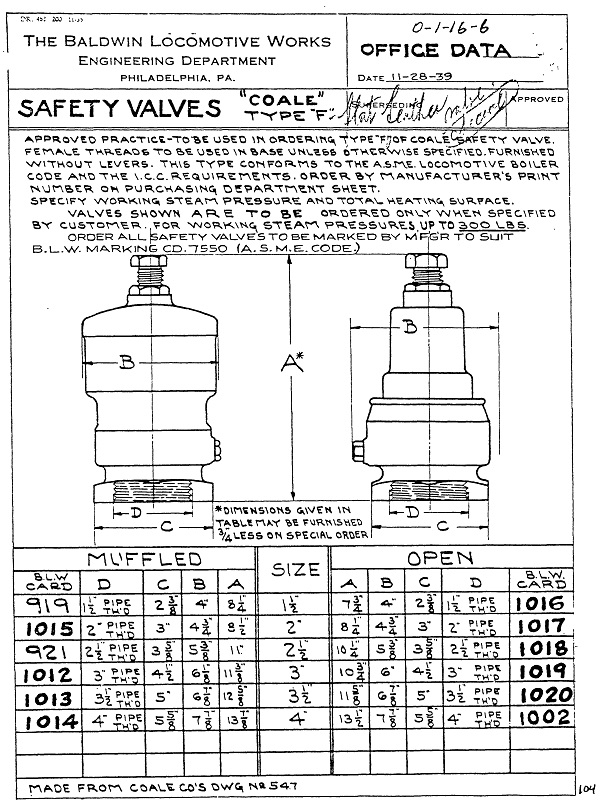

Here is some information from the Baldwin Standard Practice Vol. 1 CD, published by the Engineering Standards committee.
Hope it is of some help.
Respectfully,
Dave Griner
BALDWIN STD PRAC 1-16-6.TIF
BALDWIN STD PRAC 1-16-5.TIF

Have done some rearranging, so here's another try.
Many thanks to Kelly Anderson and PMC
Dave
