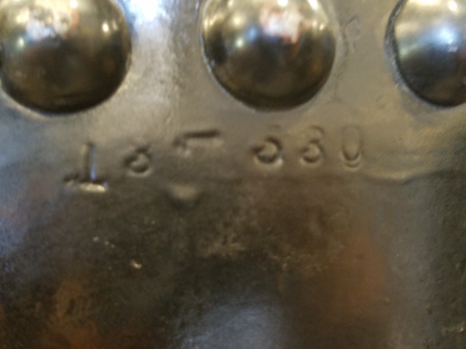

The discovery of the Extra Order builder's plate rivet holes was followed by the discovery of a stamp found on the right side water leg close to the top of the grab iron. The stamp reads 13-530 (I believe). I'm not sure if this has any relation to the extra order tank order.
If anyone has any information about what this stamp means or any other information about its Extra Order tank, I'd love to hear it.

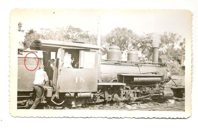

Baldwin extra-order tenders definitely carried their own builder's plates. From photos I've seen (e.g. SR&RL 2-6-2 No. 18's replacement tender, to cite one prominent narrow gauge example -- see photo below), it was a single plate in the standard Baldwin style, placed on the engineer's side of the tank above the grab iron, just as the original poster describes.
-Philip Marshall

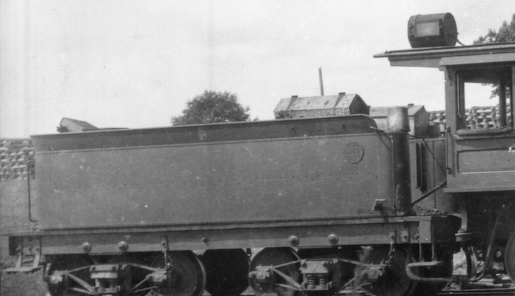

Just to show what I was talking about in my original post better, heere's SS&S #4 (6's sister) in 1920 with the extra order plate on the tender. The tender plate reads 16584, May 1914. I might note that this picture is mirrored; this is actually the fireman's side. Does anyone know when the Sandy River prairie got its extra order tender or what number the plate is? I can't make it out from the photo.
But back to my original question...if anyone has any leads on what the "13-530" stamp on engine #6's tender means in relation to the extra order (if there is any relation), that would be be amazing.
Thanks!

SR&RL No. 18 is supposed to have received its extra order tender when it was converted from a 2-6-0 to a 2-6-2 in 1/1916. The work on the engine itself was done in the MEC shops, but the new tender was provided by Baldwin. I haven't been able to find the construction number of the tender, but the engine was Baldwin c/n 13733, built 9/1893.
Other SR&RL 2-6-2s that are supposed to have had Baldwin extra order tenders include Nos. 16 and 24, but No. 18 was the one I happened to have a picture of.
I hadn't realized that the plates would be on both sides, but of course!
-Philip Marshall

If it helps any -- and I think given the chronology it might -- I think the 'stamp' in the picture starts with 18- and not "13-". As such I think it may well be the actual order number.
