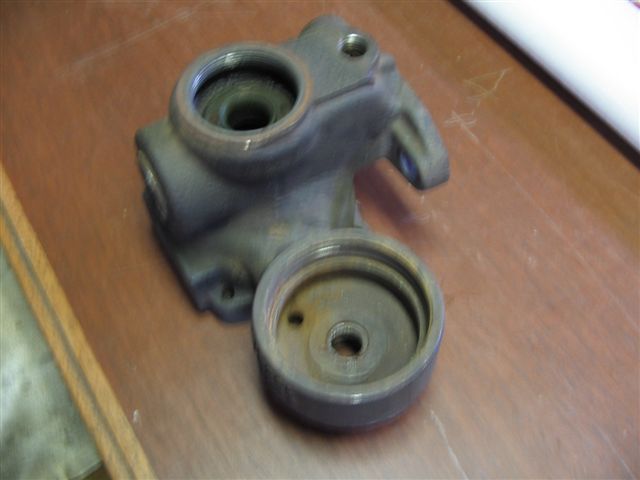

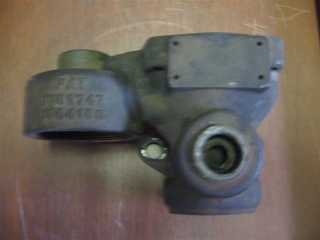

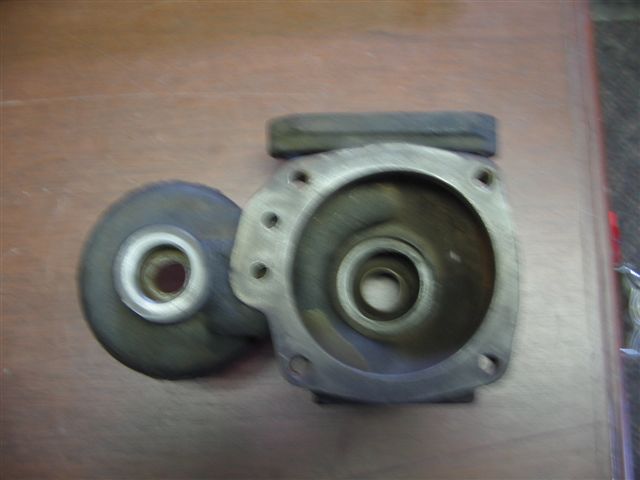

Does anyone out there have an idea of what type valve this is? I have been able to find the patents, but the description is somewhat generic. I apologize for the poor quality of the images.

looks like a triple valve, maybe a type "p" from an old passenger car? I've seen two types, "L" and "P". L's attach directly to the brake cylinder, I don't think the P's do.
 Post subject: Re: Brake Valve
PostPosted: Tue Mar 02, 2010 12:15 pm
Joined: Thu Dec 17, 2009 10:56 pm
Posts: 46
Personally, I think this resembles a feed valve bracket moreover than a L triple valve. I could be (and most likely am) wrong, but I hope this provides some direction for you Wayne.
Take care,
Jeff
<Some relevant quote.>
PostPosted: Tue Mar 02, 2010 12:20 pm
Not an "L" valve. Looks to me to be some sort of ancient feed valve, perhaps mounted directly to the automatic brake valve in the cab.
And am curious now about what it really is...
Direct Release, CT
PostPosted: Tue Mar 02, 2010 12:42 pm
Joined: Sat Aug 21, 2004 11:19 pm
Posts: 37
From what we can tell it is a feed valve. What type is the question.

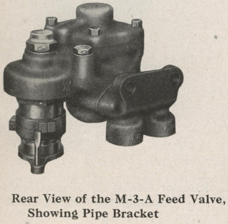

I too will put my money on a Feed Valve. Here is a photo of an M-3-a feed valve from a Westinghouse 6-ET booklet.

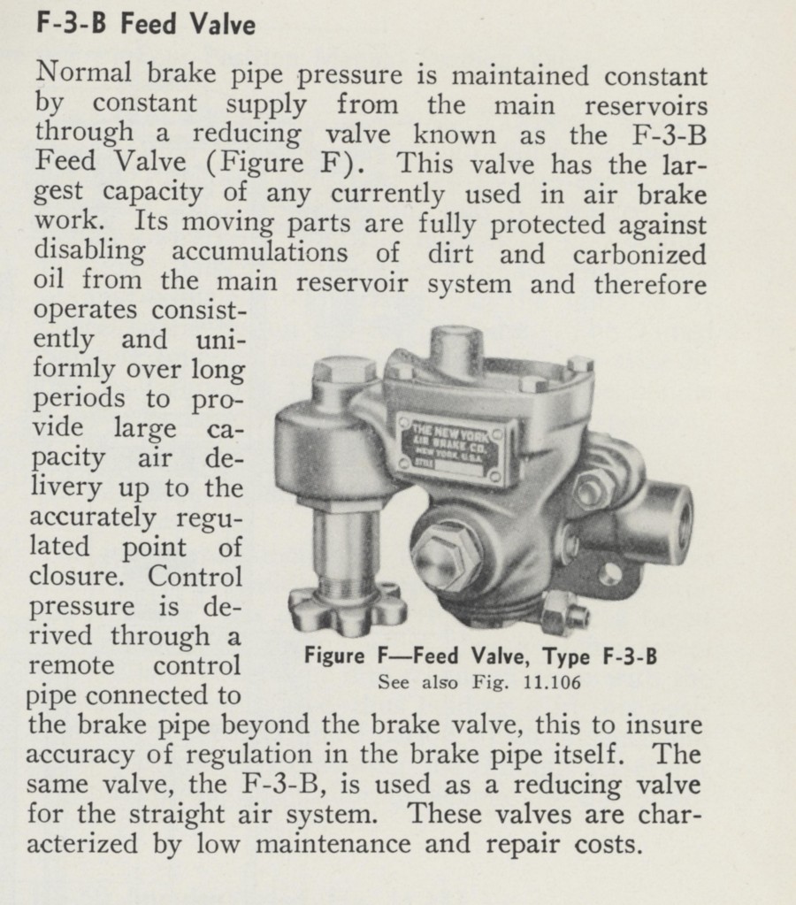

It looks like the body for a F-3-B single pressure or an F-4-B double pressure feed valve The New York parts catalog says they use the same body. WABCO part #501187 NYAB part #EV-2180.
 Post subject: New York Air Brake F-3-B and F-4-B Brake Valves
PostPosted: Tue Mar 02, 2010 9:55 pm
Posts: 1118
Location: Warszawa, Polska

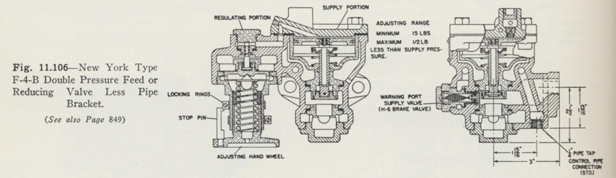

Here is what I was able to dig up on the New York Air Brake F-3-B and F-4-B Feed Valves

My guess would be that this feed valve bracket came off a NYAB 14 EL stand. Brendan, did you happen to strip this off the 9331? Just curious, as it seems that this type of feed valve was associated with 14-EL brake equipment found on older diesel-electric switching locomotives.

F-3-B it is. I thought that may be the case, but seeing as the NY air brake catalog in our shop is missing the sections on the F3 and F4 valves, and interestingly enough skips right to F6, I could not verify. This valve is one that we had in storage in our "boxcar o' brake valves". 9331 is equipped with M3 valves and 8618 has a D-24-B. The use of this valve will be in a non-standard application, probably not worth the time to describe. Thanks to all for the information.
