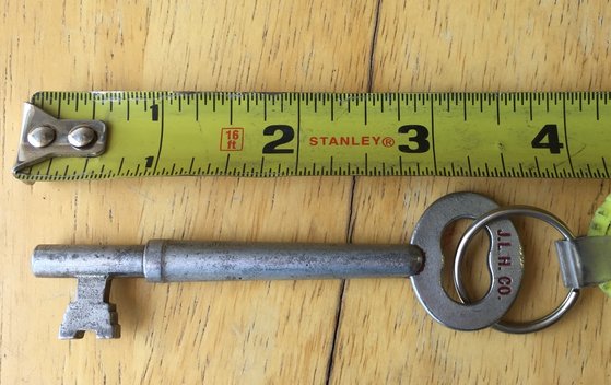

Help! I need a replacement for this key, We only have one copy, and I need one to access this caboose.
I will be happy to buy it and pay shipping
Picture below

Blast from my past, but what's it got to do with a caboose key? Might want to start a new thread about the key so it can be found.
Dave, I messed up, but I did start a new thread for the key
