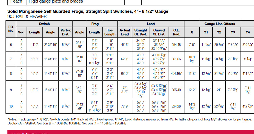

Hi Rick
I found this information off the LB Foster Rail website it's not a diagram but has dimensions, the closer rail for 115lbs is in the (C) dimension. hope this helps you, Pat

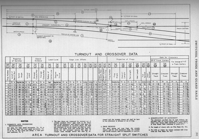

Here you go. This is for straight switches. If you can't read it due to the small file size or need the data for curved switches, pm me. I hope this helps.

I'd suggest being careful about posting AREMA/AREA drawings, they're copyrighted. Yes, I know the books cost a small fortune, I have a set.
Also keep in mind that AREMA Standards are anything but standard. The UP/BNSF Common Standard Turnouts are not the same as AREMA. Those can be found online, but they no longer support #6 turnouts. You can still find old drawings online, just takes some work.

"I'd suggest being careful about posting AREMA/AREA drawings, they're copyrighted." Bob, you're absolutely right. I should have known better. Even being published in 1955, S&B still has the copyright. Maybe they're legal team will give me a break since I can't read anything worthwhile from that scan.
