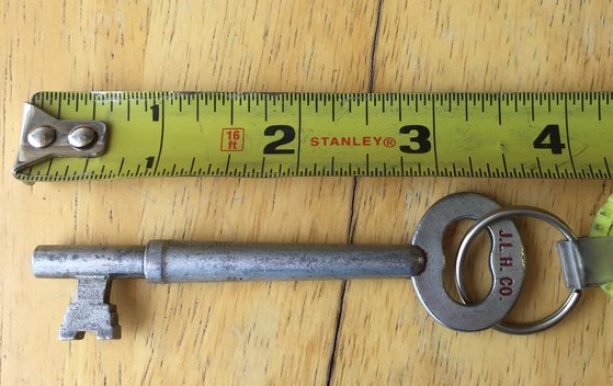

Help! I need a replacement for this key, We only have one copy, and I need one to access this caboose.
I will be happy to buy it and pay shipping
Picture below

It looks like the same key they used on the passenger cars. That might make it easier to find.

That item was always, always called a "coach key" by Santa Fe employees. In the 1970s and 1980s (i.e. when I lived along the Santa Fe main line in Illinois) every engineer, conductor, and brakeman had them hanging from their belt by a dog chain type hook, along with any MOW track gang people who used camp cars. They opened doors to all Santa Fe engines, cabooses, and passenger cars, including camp cars that had been converted from former passenger cars. As a bit of trivia, a lot of the time the track gangs would hang their keys precariously on the turn signal of one of their 6-wheeler trucks, I would bet that is what happened with my set, I found them (including a bunch of flat keys for master locks, a whistle and a small crescent wrench!) laying on the ground a week or so after a track gang had left town. I am not interested in selling mine, but if you search around for a Santa Fe coach key I am sure you will find one, there must be thousands of them out there, since they no longer are used on locomotives (they use a regular switch lock that takes a flat key now), the camp cars have mostly all been retired, and no cabooses obviously, so possibly only the executive cars would need them. (Tried to post a photo of mine, it is identical, but I can't seem to get it small enough for it to let me post it).

Its illustration under "Keys" shows the old style coach keys.
I'm quite sure the key you show is the same as the Santa Fe coach key. Mine is one that was also made by JLH about 40+ years ago. Orange Empire acquired both SP/UP and ATSF coach keys because it had cars using both through an independent railroad equipment manufacture's representative.

Good news! I spoke to Fred at JLH and he identified it as their model 2555. I mailed the check today for 2 keys-one for me!

It's a standard Adams & Westlake key/lock deal. I have several in my collection that are all identical yet all marked (and unmarked) for various railroads. They used these locks on cabeese, coaches, baggage cars...and so fourth. A&W can provide them...glad you found another source. Ebay is another good choice. I doubt you would ever find a locksmith that would tackle this.
