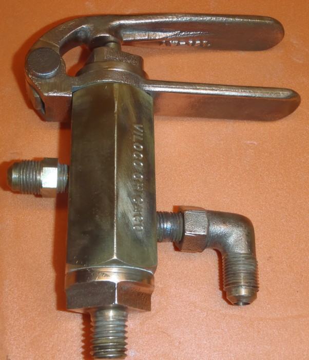

Gord M wrote:
If I recall correctly, both 2816's whistles are sounded by steam. Some CP locos had an air operated, whistle valve to admit steam to the whistle resulting in abrupt, unpleasant (IMHO) whistle blasts that no doubt, conserved a bit of steam over time.
Many engines were equipped with a device called the Viloco Whistle Operator and it is a small pneumatic piston that acts on the same whistle valve that the pull cord is attached to, and is operated by a control in the cab.
When it is used, it produces a distinct sound from the whistle, compared to when the whistle is being blown via the pull cord, and I guess you could describe it as being all the way open or all the way closed. There is no quilling of the whistle as there is with the pull cord.
File comment: Viloco Whistle Operator Valve

 Post subject: Re: Steam locomotive whistles
PostPosted: Fri Oct 13, 2017 4:12 pm
Posts: 1182
I can recall hearing the Viloco device sarcastically referred to as a "button whistle." The CP 1200-series Pacifics were so equipped, I know that for certain.

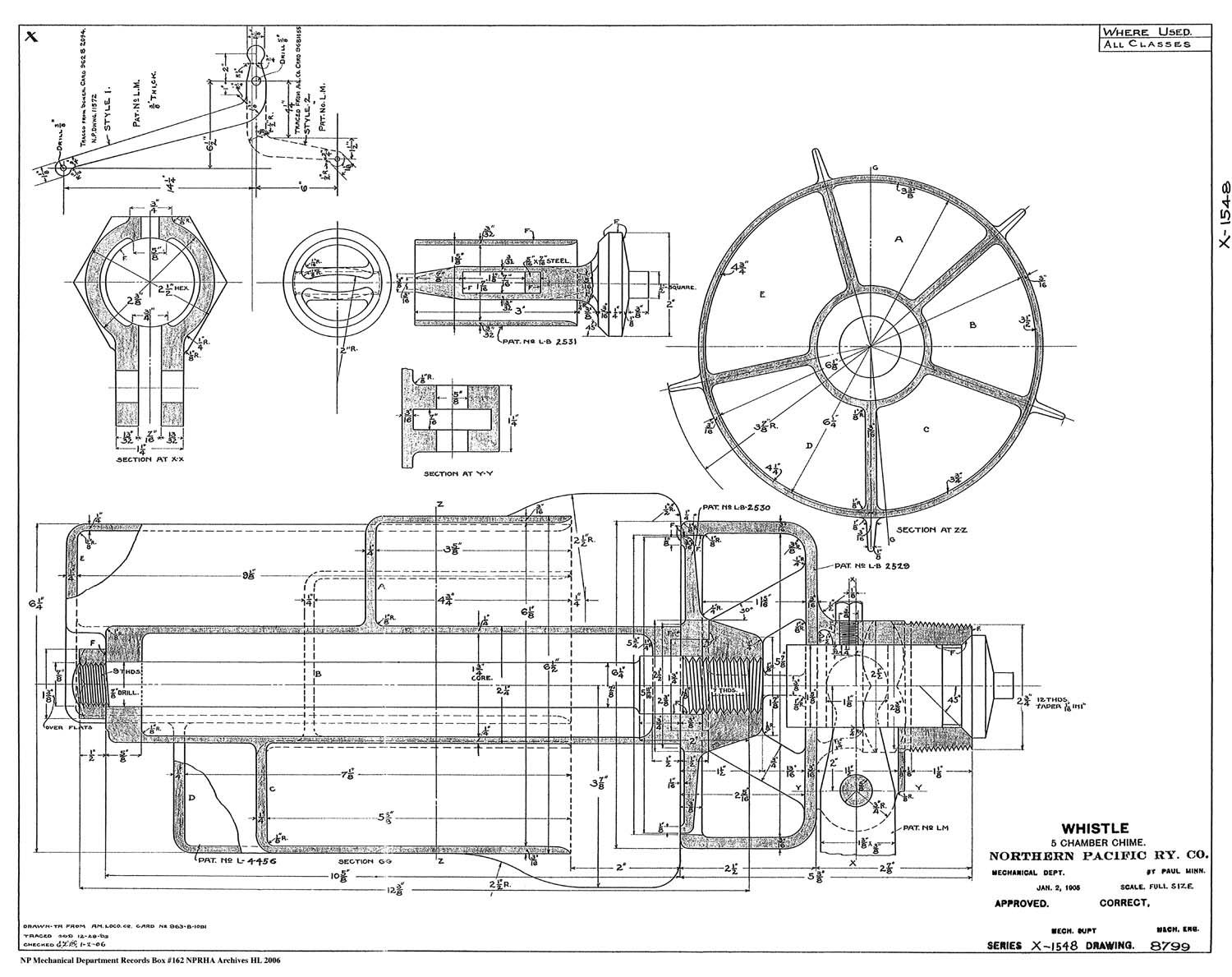

Posts: 548
From the NPRHA Archives
