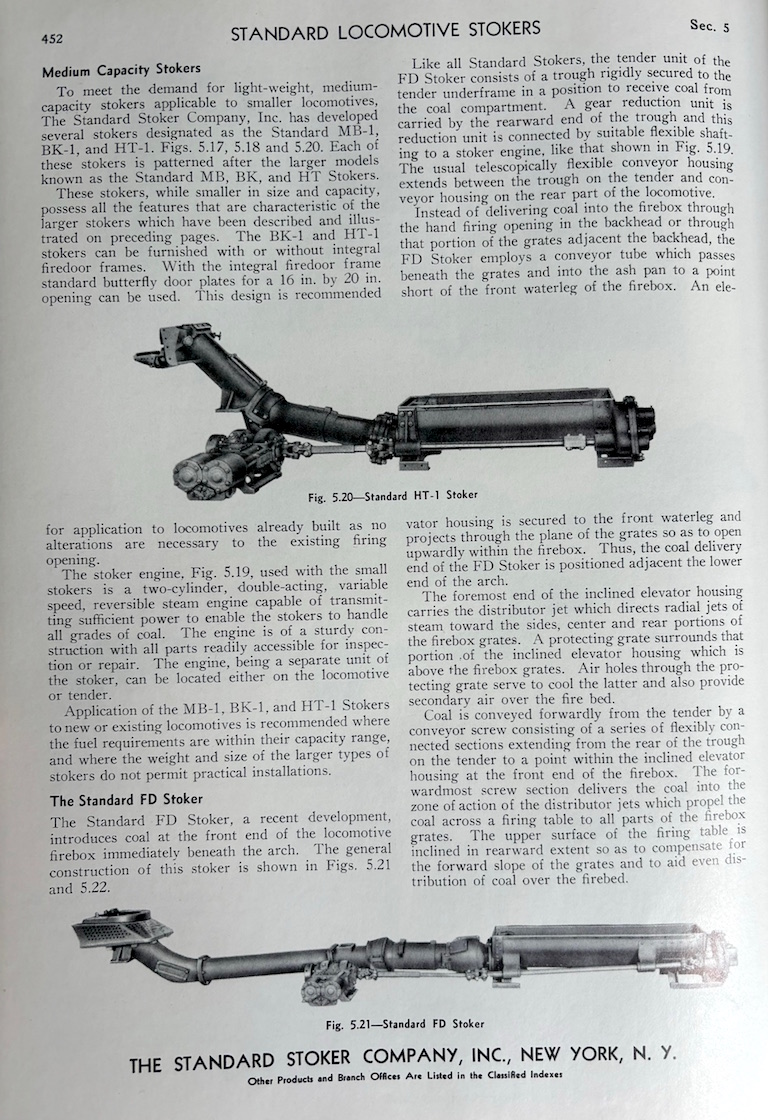

I just picked up Staufer's book "B&O Power" and there are a few paragraphs given to the idea of "front feed" stokers in the experimental section of the book.
In concept, I can understand the motivation and general layout, but are there any pictures of these contraptions? Agree that coking or clinkering in the screw tunnel could be a problem, if these were, in fact, run right under the grates.

Here's a rendering and description from the 1941 Locomotive Cyclopedia. It's a Standard FD type stoker at the bottom of the image.

What was the point of the FD stoker? To deliver the fuel from under the arch, to create a longer (potentially) combustion path?

"What was the point of the FD stoker? To deliver the fuel from under the arch, to create a longer (potentially) combustion path?"
Precisely. Or a little more precisely, to provide the functionality of a typical throat-fired oil setup using solid fuel.
Running the conveyor all the way under the ashpan would have been suidical without modern nanoinsulation or the equivalent. Perhaps they theought it would nicely preheat the coal without supporting combustion if the dwell time got to be too great. Compare this with the fun with the chain grates on the N&W M-2 Automatic and then the TE-1, where rolling out the partially-ignited coal was less involved and for a shorter distance...
Even with relatively automatic jet and coal-flow characteristics (see some of the patent lawsuits about stoker distribution-plate design) it's going to be tough to figure out how the plume ought to be fed, or how much of it needs to 'drop out' to maintain the right firebed over its length, or prevent fines or ignited lumps making their way 'around' the nose of the brick arch for longest TOF from grenading against the firedoor or observing glass... better be sure it's quartz, or the right kind of isinglass... ;-)
 Post subject: Re: "front feed" stokers
PostPosted: Wed May 15, 2024 5:02 pm
Lo and behold, the FD remains illustrated in the '47 Cyc (on page 403) where it is described as being developed from the MB stoker. They cryptically note that the conveyor is extended 'under the mud ring and the grates'. I see no indication of insulation on the part of the conveyor enclosure that goes beneath the whole length of the firebox...

I can imagine the steam jets on the stoker table with this arrangement would consume less steam than with a normal firing arrangement. The stoker is distributing coal in the same direction the draft is already flowing (towards the rear of the firebox before turning upward around the arch). So lower steam flow should be sufficient to adequately distribute the coal since you’re not trying to propel the coal particles against the air flow. This would be doubly beneficial, as you’re reducing the steam consumed by the stoker, and you’re injecting less steam into the exhaust gases above the firebed. The steam injected here has to be drawn through the tubes which is a loss for the drafting system (work done to move waste steam instead of combustion gases).
Likely the other obvious drawbacks outweighed the possible gains I’ve suggested.
