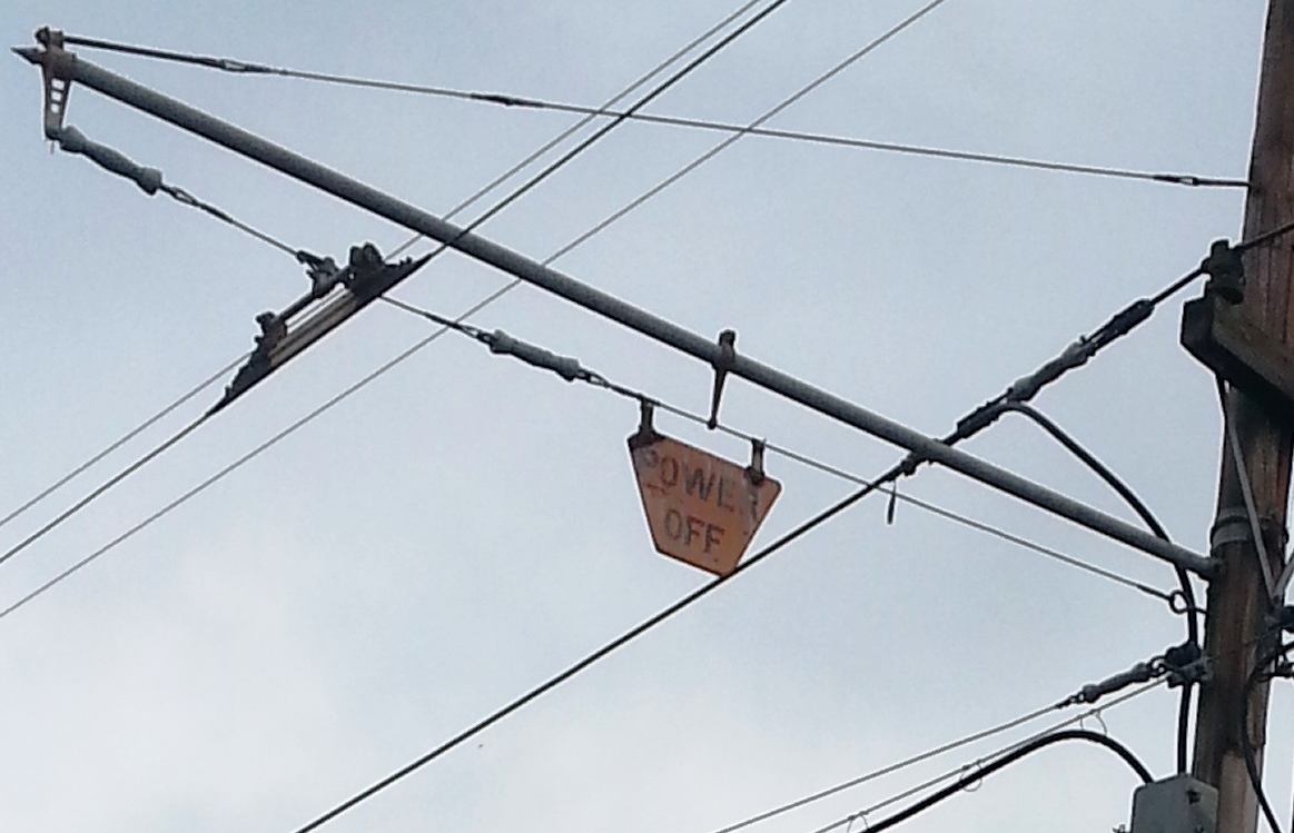

Attached is a photo of a Pittsburgh Railways Co. "Power Off" sign next to a section insulator at Pennsylvania Trolley Museum.
There were no similar signs at Cheatham electric switch contactors since, depending on which way you wanted the switch to throw, you might be coasting or pulling power. In Pittsburgh, the protocol was coast for the straight and pull power for the diverging. At PTM, we reversed the protocol so as to better adapt to the way our railway is configured.

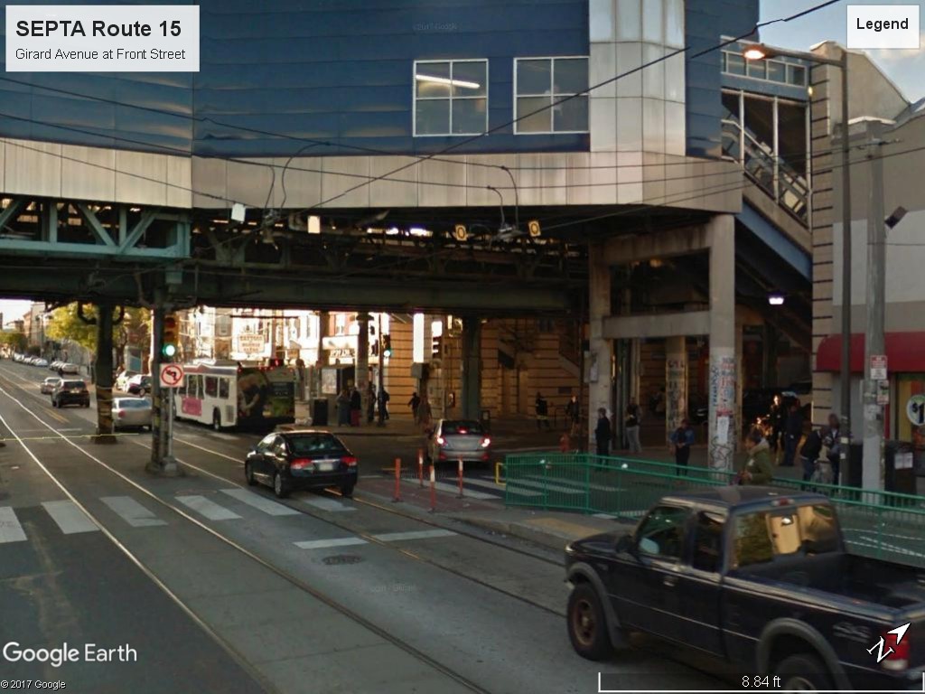

Was or is there any sign or signal for trolleys or any trains with overhead to tell the operator to cut power off and to resume power?
The attached picture is from the SEPTA Route 15 on Girard Avenue just east of the Market Frankford Elevated Station. I imagine the "0" means no power over the insulating break.
Brian
