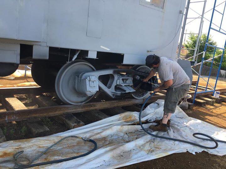

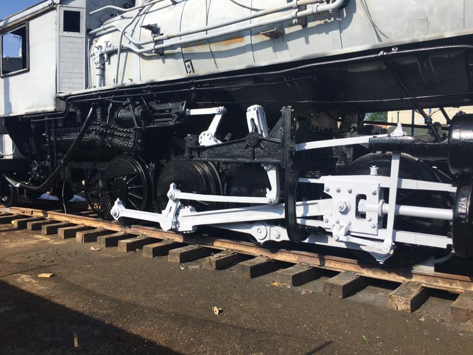

These photos are courtesy the Corbin Convention and Tourism Convention and show the progress on L&N 2132 in Corbin, KY. As you may recall, 2132, a South Louisville Shops-built 0-8-0 languished for decades in Bainbridge, Georgia. It was rescued a few years ago and is undergoing a cosmetic restoration. I believe Wasatch Railroad Contractors is undertaking the work.
I wonder what kind of paint they are using to paint out in the open like that. I assumed that some sort of tent was usually required. Anyone know for sure?

Locomotive looks pretty good thus far in primer. This is the engine that was "cut in two" before its first move. Do you possible have a side view of the 0-8-0 that might show how this cut now looks?

Looks good but they need to remove the visor from the headlight.

The locomotive was cut into 3 pieces when it got to Bainbridge, as they wanted to make it fit on a city flatbed truck to get it from rail to the park. The flues, tubes, tube sheets, grates, grate bearers, and a lot of other internal parts and piping were removed and scrapped at that time. Once it was in place in the park, they did a quicky "weld" job that left large gaps between the cut sections of the boiler.
The new jacket pretty well hides the torch cuts in the boiler. The main rods and side rods were cut as well as the frame, at the same time. Imagine putting the locomotive into a giant guillotine and making two cuts from top to bottom, leaving three pieces, and you'll get the picture.
The headlight visor will go away and the lense will have "2132" painted on it.
The photos show it being primered, not painted.

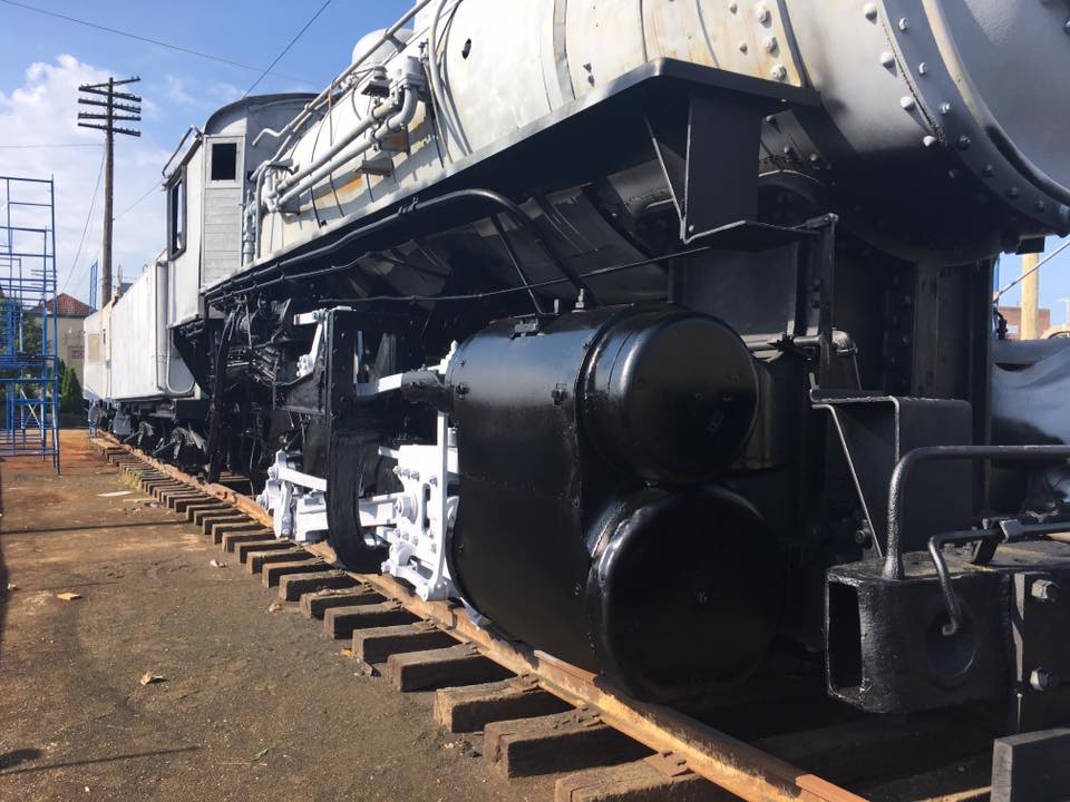

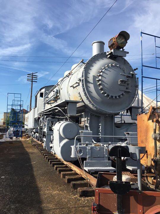

Here are some photos of the locomotive, after apparently receiving some black primer, which looks a lot like finished paint.
Seriously, will look nice when finished.

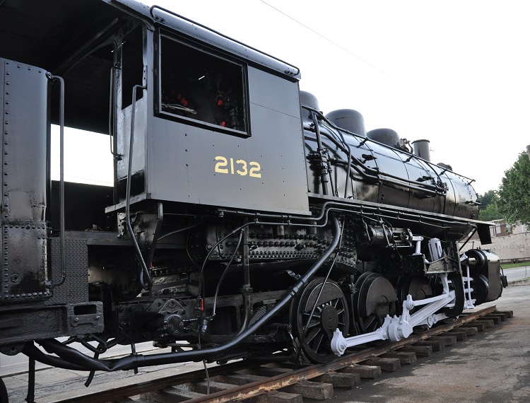

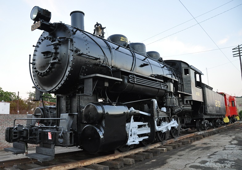

Passed through recently....

It really does look nice considering how badly it has been treated in the past.
