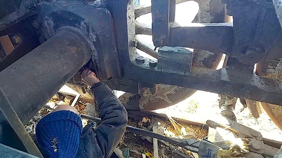

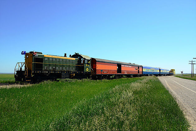

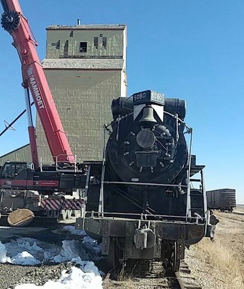

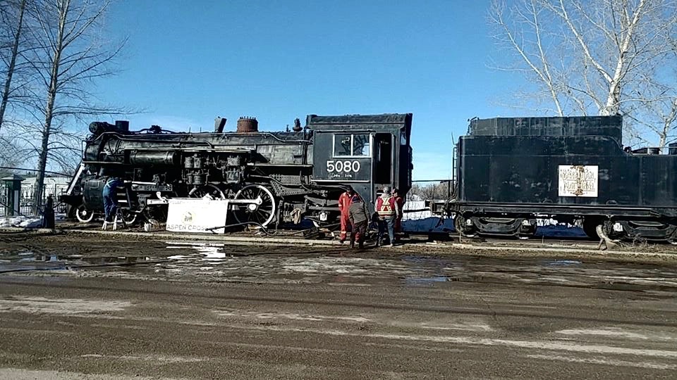

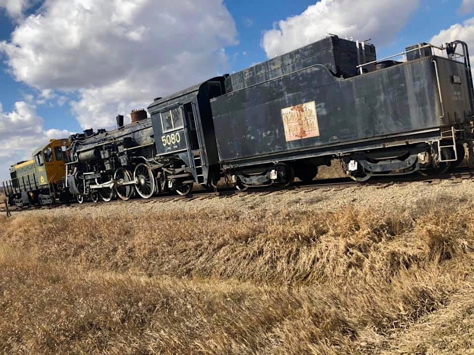

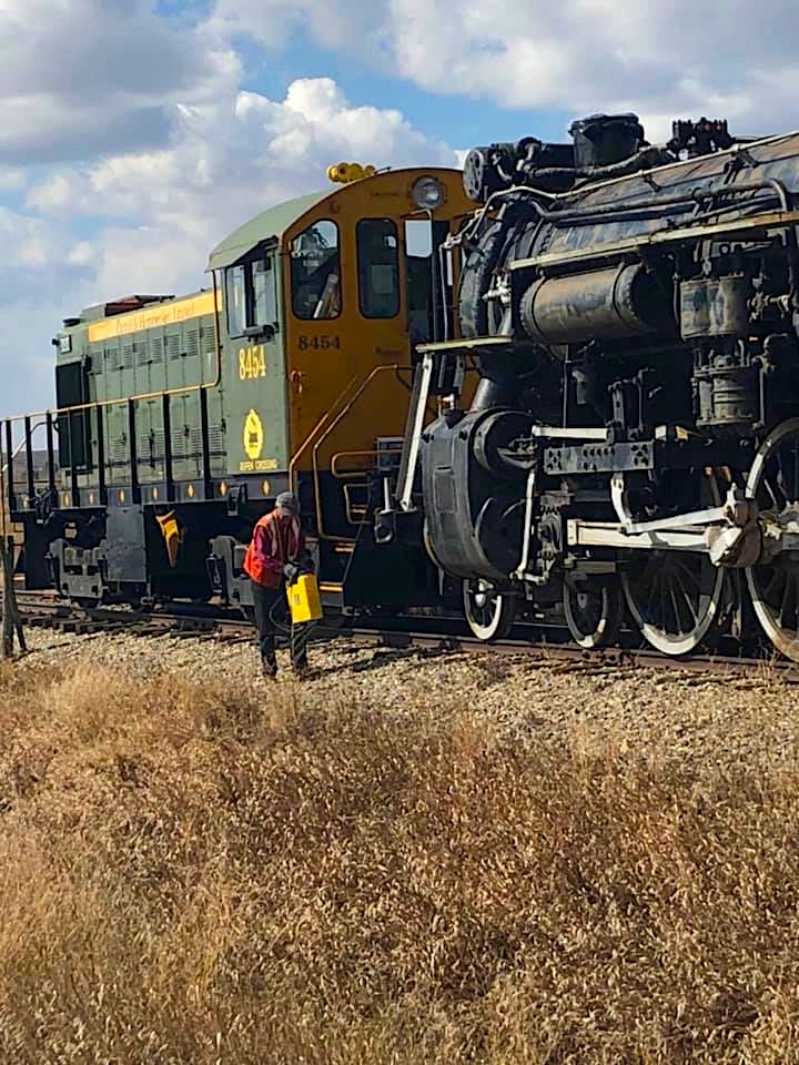

After the two Hiway trucks were off loaded at Mossleigh, Alberta, the tender was reconnected to the engine. The engine was then prepped for rail movement to Aspen Crossing. Naturally this involved lubricating the driver axles with fresh grease. Usually a simple process. Not so this time. After years of sitting in a park, the grease had solidified into concrete hardness. The usual method of pumping fresh grease into the fittings...did not work. The old grease would not budge from the axles. The solution was to allow the drivers and axles to sink down under their own weight, as the engine was being lifted by the giant cranes. This worked, and fresh grease was flooded in around the bearing surfaces. Safely lubricated, the engine was towed to its new home by ex CNR 8454....an S3 Alco. Constructed by Montreal Locomotive Works in 1952.
Spent many years in Canadian Prairie service. Now the perfect stablemate for 5080. BTW. That's Al Broadfoot inspecting the grease cellars. The remedy worked, and 5080 arrived safely.....Now parked outside Jason's office window at Aspen Crossing.

Were the pistons greased as well? The grain elevator in the collection is a nice statement about CNR service on the prairies.
Let's talk about the long range projections for the locomotive.
 Post subject: Re: CN 5080 Update
PostPosted: Fri Apr 05, 2019 1:06 pm
Posts: 172
The pistons and the valves were heavily lubricated with oil. Including cross-heads and guides. Also the piston and valve packing was removed. The engine was moved slightly ahead, and relubed several times to distribute evenly over the bearing surfaces. It was done this way, as the move was only about a mile, and done at very low speed. Simpler this way. It worked fine. Inspection on arrival showed no damage to bearing surfaces. In answer to your other question. First thing is removal of fittings, the jacket, and handrails, etc, so the actual condition of the boiler can be properly evaluated by ultra sound and hydro test.. Everything depends on that. When the true condition is known, the project will proceed. Initial visual inspection would indicate a good boiler...But...you never know. At this time, the long term plan is to have it rebuilt to operating condition. And, of course, it has its own railway to run on.

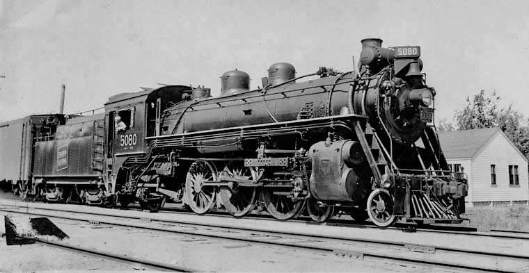

Yes, they were a good looking loco's...as this July 1947 'net photo shows. Grand Beach, Manitoba. Montreal Locomotive Works. April 1914 J-4-a.

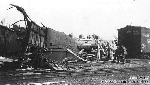

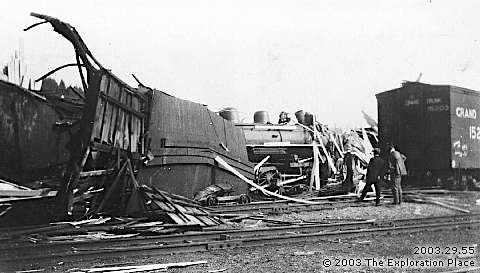

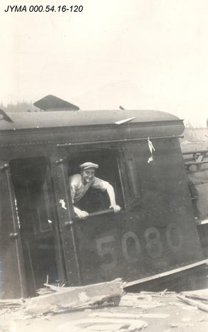

It wasn't all sunny days for the 'ol #5080.
She had a bit of a blighty in Jasper, AB back in 1925 -

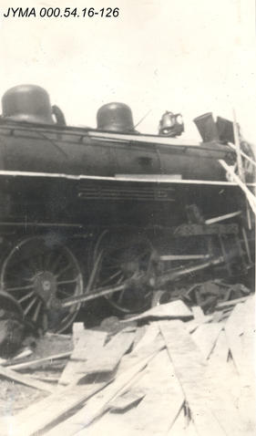

RwC. Thank you for posting those Jasper shots. That video link nicely shows the slow pace of the move, and the valve gear doing its thing. Have you any more info about the Jasper incident ? Recent close inspection of wear patterns under the engine, strongly suggest, for a road engine....it spent an inordinate amount of time backing-up. As in switching duties. Do you think the Jasper shots show it in possible switching service..?
PostPosted: Sat Apr 06, 2019 10:58 pm
Posts: 107
OldSmokey - From what little info I could find, the pics from Jasper are the result of a runaway. #5080 got away from the hostler and decided to go for a jaunt. I know that engine inside and out, I'm one of the ones responsible for it going to Aspen Crossing. I've been working on making something happen with #5080 since 2005 and have built up a very large research file on the locomotive. In regards to the tread wear, Al Broadfoot and I discovered the unusual wear on the pilot and trailing truck when we did our preliminary mechanical inspection several years ago. I dug through my records afterward and found near the end of it's career, the engine was assigned to local assignments around Price Albert that required it to push and pull loaded lumber cars for the local paper mill. Knowing the terrain and the routine from the diesel era, I assume it pulled the loads to the mill (some of it up a two way grade), cut off, ran around the train, pushed/spotted the cars and pulled the empties backward into P.A. A couple of years of that with the sanders on would account for the grooving.
