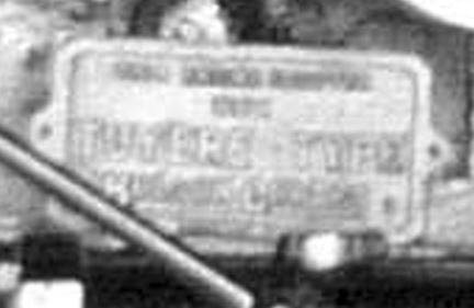

I am unable to discern much from this plate, but it may be familiar to others in the group.
If you know of a duplicate, please contact me through this board. If you can provide me with a clear photo, a tracing or rubbing on paper, and dimensions, that will work as well.
Thank you for any and all help.
Dick
File comment: Missing plate, broken by vandals and parts removed.
We'd like to get or make a copy.

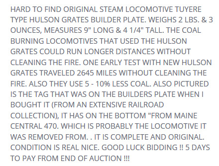

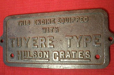

I found this information on worthpoint, and according to label, the plate came off of Maine Central # 470. I GOOGLE Tuyere builder plate and found this, Pat From WLS.

This was taken from our locomotive. Apparently it was placed on eBay in April of 2013, and was sold to a collector. Perhaps an A.P.B. could find it out in the world, but more than likely we'll have to find a new one or have one cast.
Damn.
Thank you for the detective work. Maybe the buyer will come forward.
That would be a nice "fairy tale" conclusion.

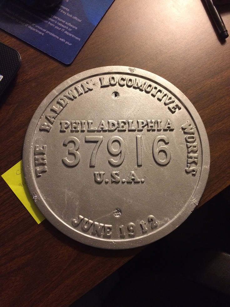

Cast aluminum plates with a "stolen from..." statement engraved in the back seem to be a good compromise. Painted black, it appears original. If the original is donated or otherwise obtained, it can be displayed or stored in a museum facility against the time when the engine is no longer running and is itself displayed in a secure facility, whereupon the original plate can be re-installed.
Aluminum replica plates are pretty common and are understood to be replicas, so have little collector value.

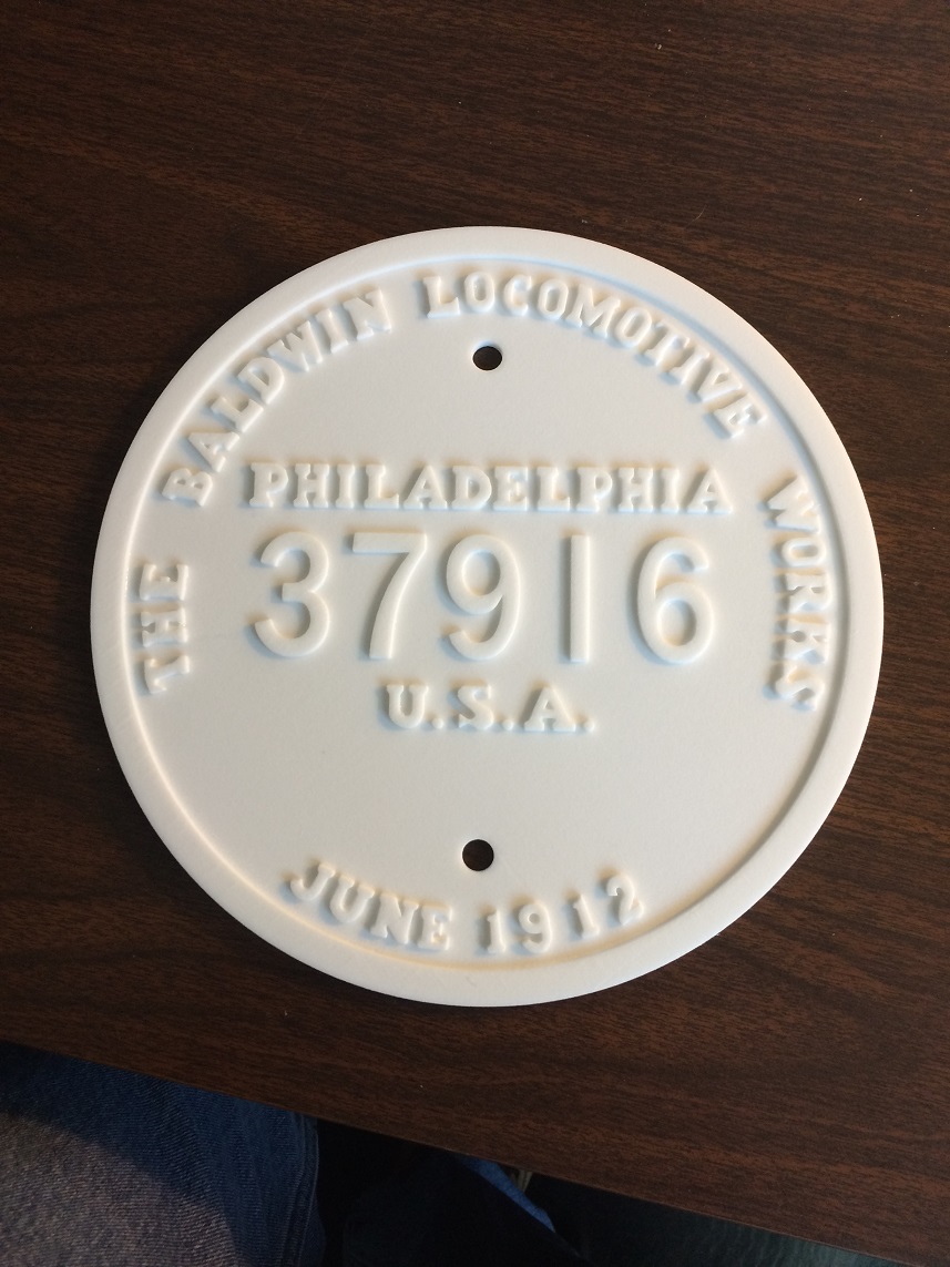

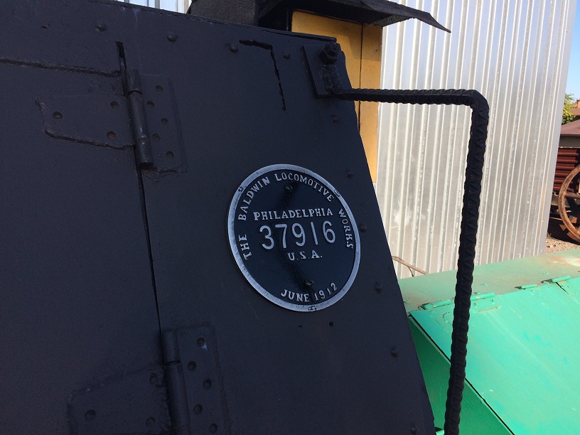

I recently had very good luck having reproduction Baldwin builders plates made for a Baldwin electric locomotive. I had a Baldwin drawing of their typical builders plate which I gave to a smart college student who then made the needed number and date changes and set it up into a format that shapeways could then use to print me a plastic pattern. The cost was about $130 for the printing. I then had six copies made in aluminum from the shapeways pattern for $50 each by the Fair Weather Foundry in Ohio. If the replacements are stolen, its no big deal.
Perhaps you have enough photos and other evidence for someone to draw it up. If you need a hand with the shapeways angle, I suspect the student who helped me out might be interested in helping you with this effort. I can always ask him.
I have attached some photos of the plastic pattern and one of the aluminum plates.

The pattern maker we have befriended does plenty of this work in wood. His patterns are "art", to say the least. 3D printing takes away some of the romance, but let's be honest, what we're after is a replacement plate, and the "romance" comes second. Somebody who knows 3D printing and is skilled at it, can churn out plenty of cosmetic part patterns in rapid order.
We have a volunteer foundry who does nice work for us, and we have aluminum 470 builder's plate copies available for $200 donation.
