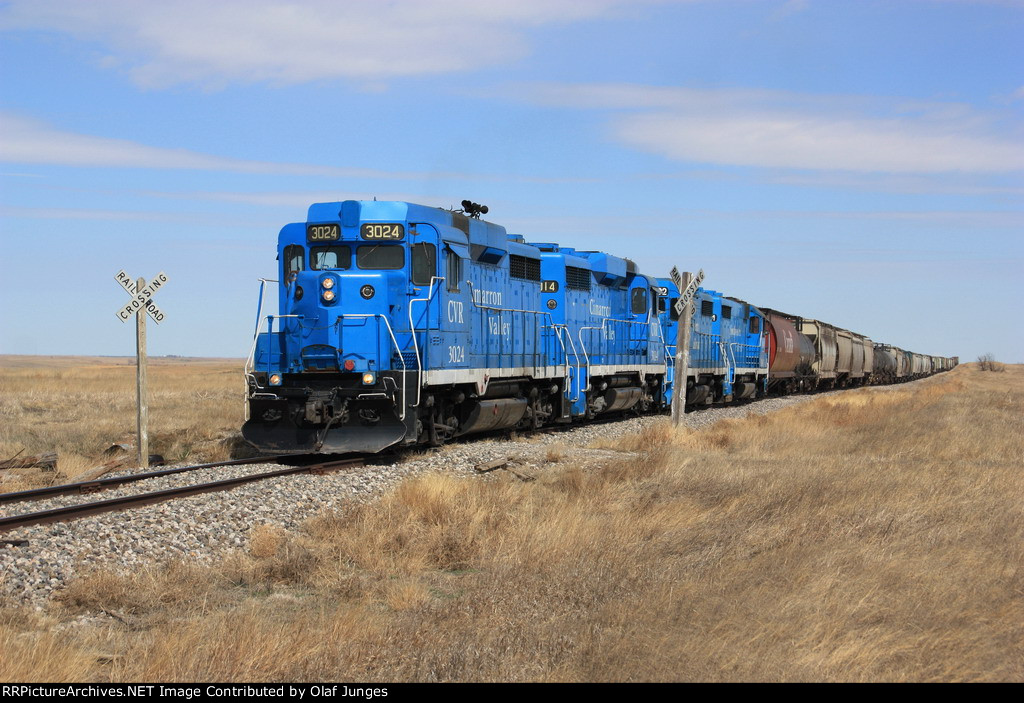

What is the origin of the units on Sterling Rail? It looks like the GATX scheme almost though I don't see them bothering with such an old unit. Some railroads completely re-did the electricals, Santa Fe among them, but I am pretty sure that is not an ex-Santa Fe unit (when they relocated all the headlights to the short hood around 1990 they cut an obvious square notch in it).
Looks like the Western Group paint scheme. Two potential possibilities are former Southwestern units, which would make them originally Phelps Dodge locomotives (Didn't they have a C&O unit, too?). Or Cimarron Valley, which would make them former Rio Grande.
I assume these are 4 of the 9 GP30's that got displaced by four SD40's and five SD50's that were relocated when the Southwestern's Carlsbad Division was closed a while back, allowing the six axle units to take over from the GP30's that were then slated for retirement and disposal.
Since there's four of them, I'm going to take a guess that they're from the Cimarron Valley. These were replaced by the SD50's, while the SD40's took over from the five GP30's on Southwestern’s Whitewater Division

LeoA wrote:
I think you are right. The funny thing is the Rio Grande units were never rewired but stayed in service through the SP merger until the UP takeover, but the GP35s were all out of service by 1990, and only returned about 1994 when SP was short of power. I lived in Denver at the time and remember the GP35s sitting in the dead line next to the Burnham shops until they were all shopped quickly and sent out.
