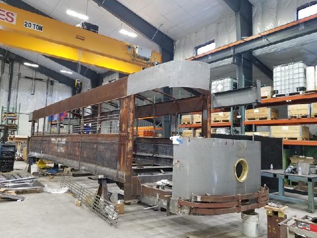

Almost there! I just received some updated photos of Scranton Transit trolley #505, which is in her last few days of metal fab! The platforms are nearly complete and workers are wrapping up remaining details, like fitting the lifeguard bumpers and newly constructed stainless steel window bars. From here, she will be taken for media blasting and a prime coat of paint (thanks to Sherwin-Williams, which has donated all of our paint products), and then immediately return to the ECTM's restoration barn in Scranton.

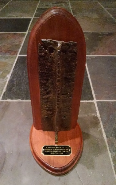

This will bring us to the end of nearly two years of metal fabrication. We could have had it finished faster, but we insisted on going the extra mile to save the bulk of 505's original side sheets and letter boards. She also carries a couple tee posts and roof carlines salvaged from sister car 601.
This work has not been cheap, so please consider making a donation. We have been able to lower the estimated cost on getting our new bi-fold doors made, and have adjusted our Go Fund Me campaign accordingly. We also still have a couple of tee post souvenirs left for $100 each. If you aren't able to donate, please share our facebook or twitter posts.

Rob, you beat me to the punch. Following a short stay at several temporary homes over the past few weeks, car #505 finally landed in Scranton yesterday at about 1 pm. Special thanks goes to Jim Eisenhard of J & E Trucking, who got her home safe and sound.
The car is now completely rust free and covered in blue sealer - a far cry from what we started with! We still have some metal repair to finish up before we can start on the wood but she's home and under cover. The truck frames are at ECTMA's Buckingham shop for rehab and we have a grant request pending with the state for the Westinghouse 510A motors.
