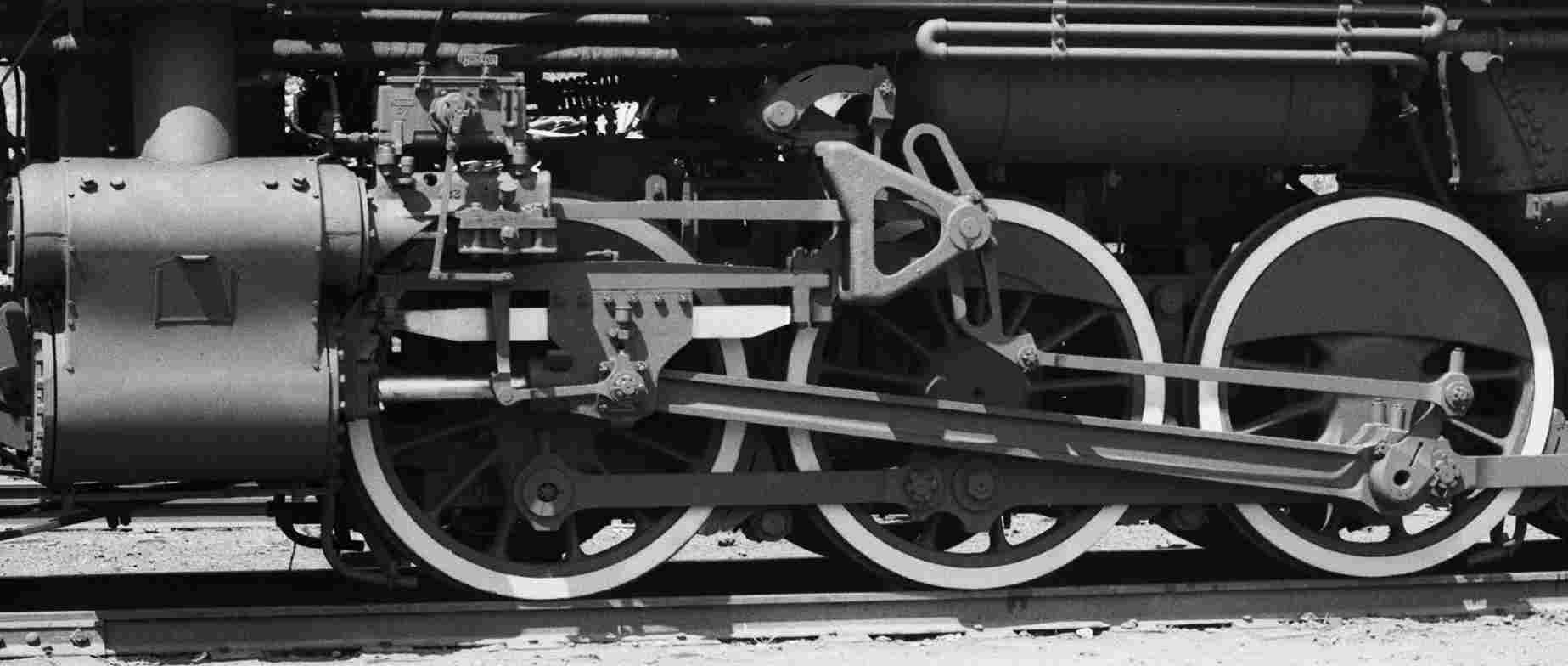

I didn't recognize the name, but going from 6-ET's description, the Alaska Railroad 550 class and over 2,100 other USATC Consolidations have indirect Walschaert's valve gear. Here is a nice photo cropped from a BLW builder's photo of ARR 555. We have drawings of most, if not all of the individual parts of the valve gear. Unfortunately, I haven't been unsuccessful in finding a valve gear assembly drawing.
The Dockstader valve gear software gives quite a bit of flexibility. It's been at least 10 years since I used it. There is a chance you could modify it, possibly with some negative values, to simulate the indirect valve gear. If you want to give it a try, I can give you all the dimensions for the USATC Consolidations.
