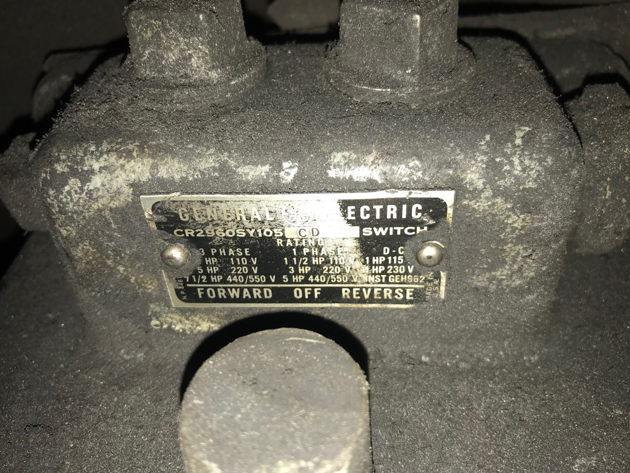

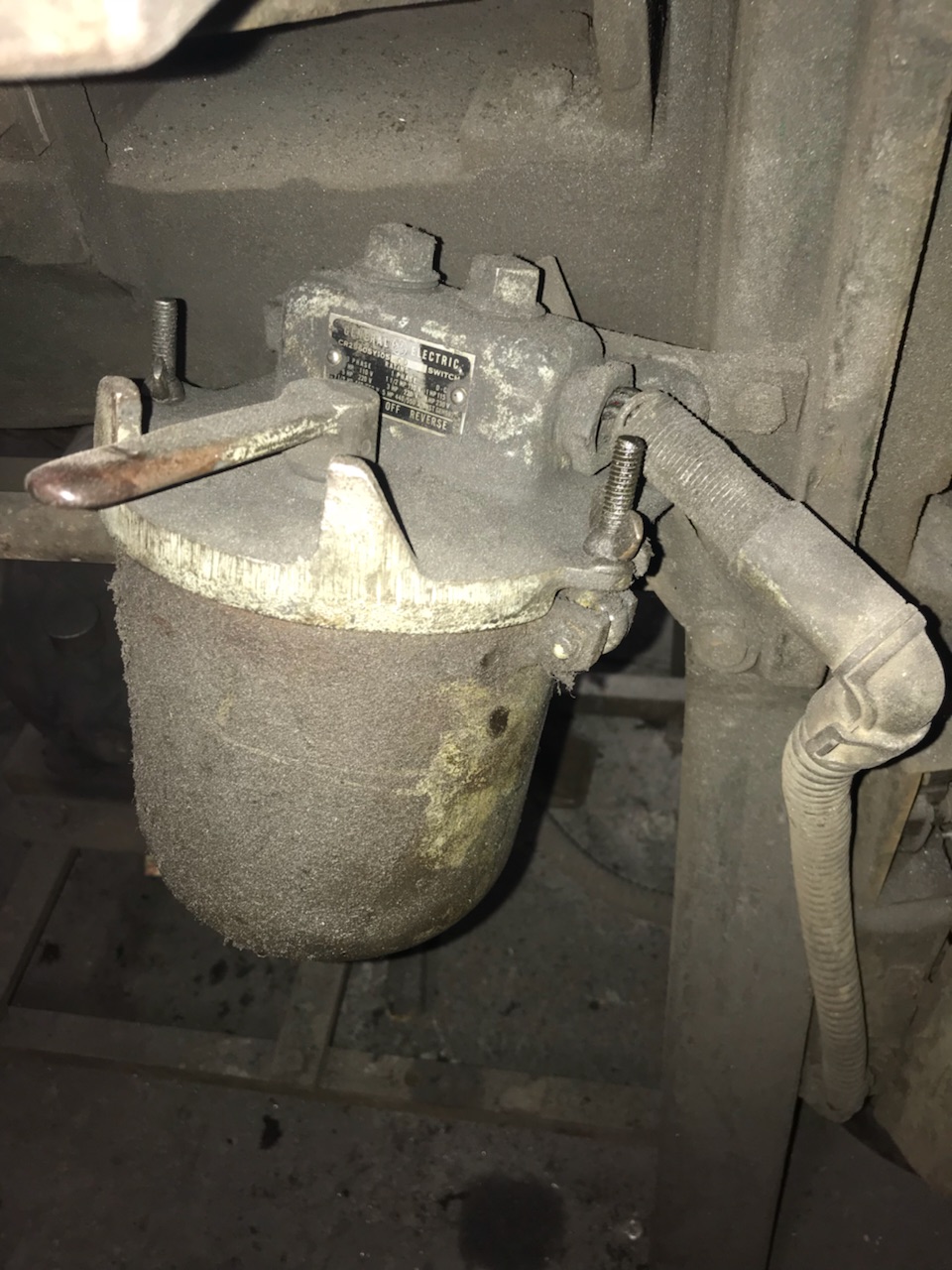

I believe the machine is still being used in production. Not so much being cheap, but the old "if it ain't broke, don't fix it" applies here. Same reason my 1951 South Bend lathe has the same switch it was sold new with. Just like the lathe, the switch is over built. I'm sure replacing the switch would not be an issue if it is justifiable, which sounds like it almost is at this point. We were curious more than anything. Neither of us had seen anything like it, and nobody we talked to locally knows.

Nowhere near sufficient rating, unless the "oil" switch is seriously oversize. The plate in the photo shows it rated 5HP at 220 V 3 Ph., 7.5 HP at 440 V. 3 Ph. The largest motor Bridgeport ever offered was 2HP, unless you count the monster Series II machines Textron offered for a time; those were 4HP, but I think they used contactors to reverse, not a drum switch.
I don't think I'd want to plug reverse a 5 HP motor with the silly little switch on my Bridgeport.

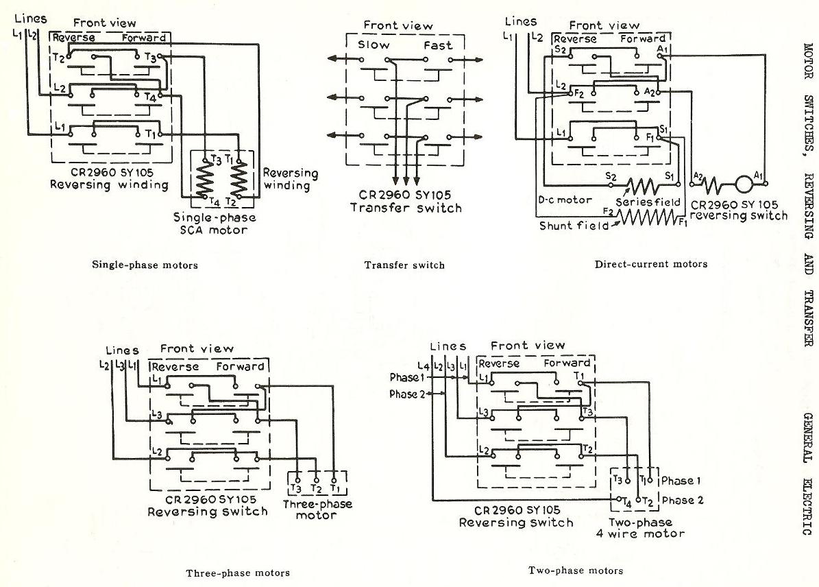

Transformer Oil (the same “stuff” used in submersible electric motor pumps etc.) will work just fine.
For reference, here’s the various connection diagrams for the General Electric CR2960SY105 switch.
John
File comment: CONNECTION DIAGRAMS FOR GE SWITCH
CR2960SY105
