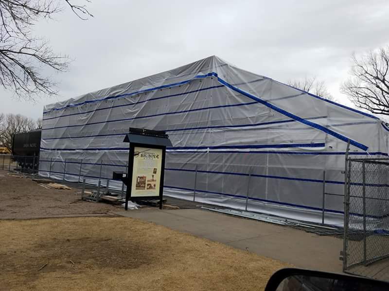

The cover is almost complete, and asbestos abatement will begin end of next week......amazing to get up this close.

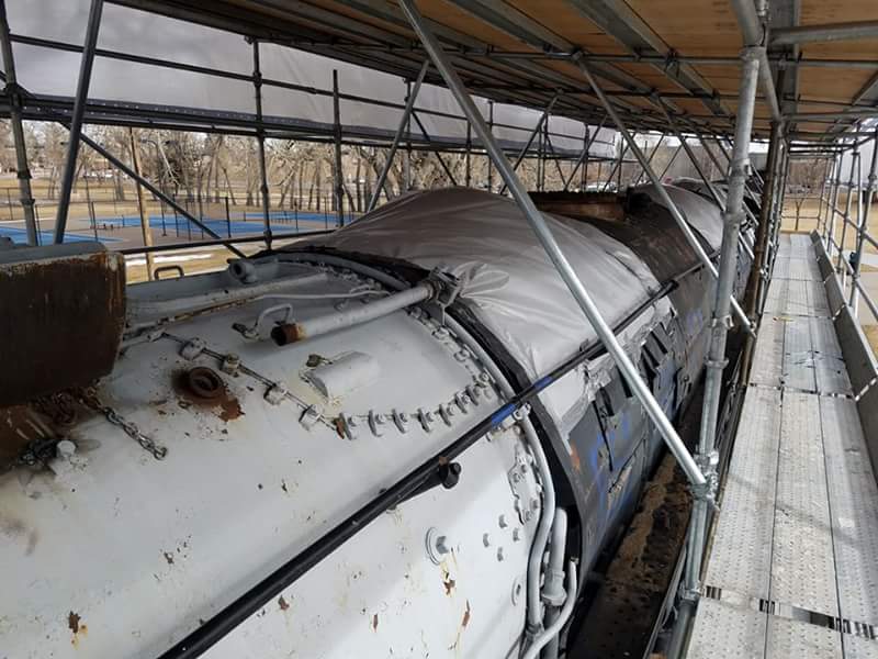

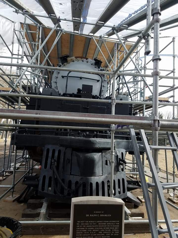

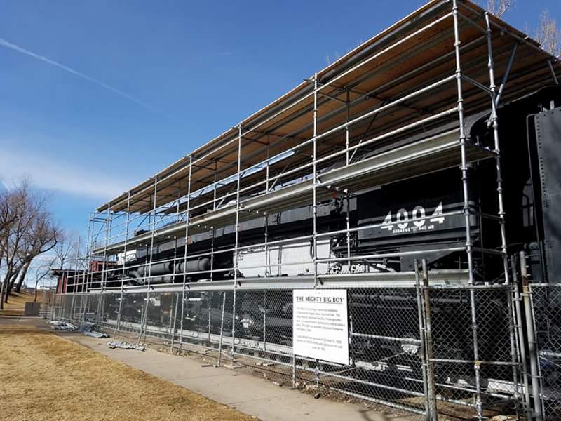

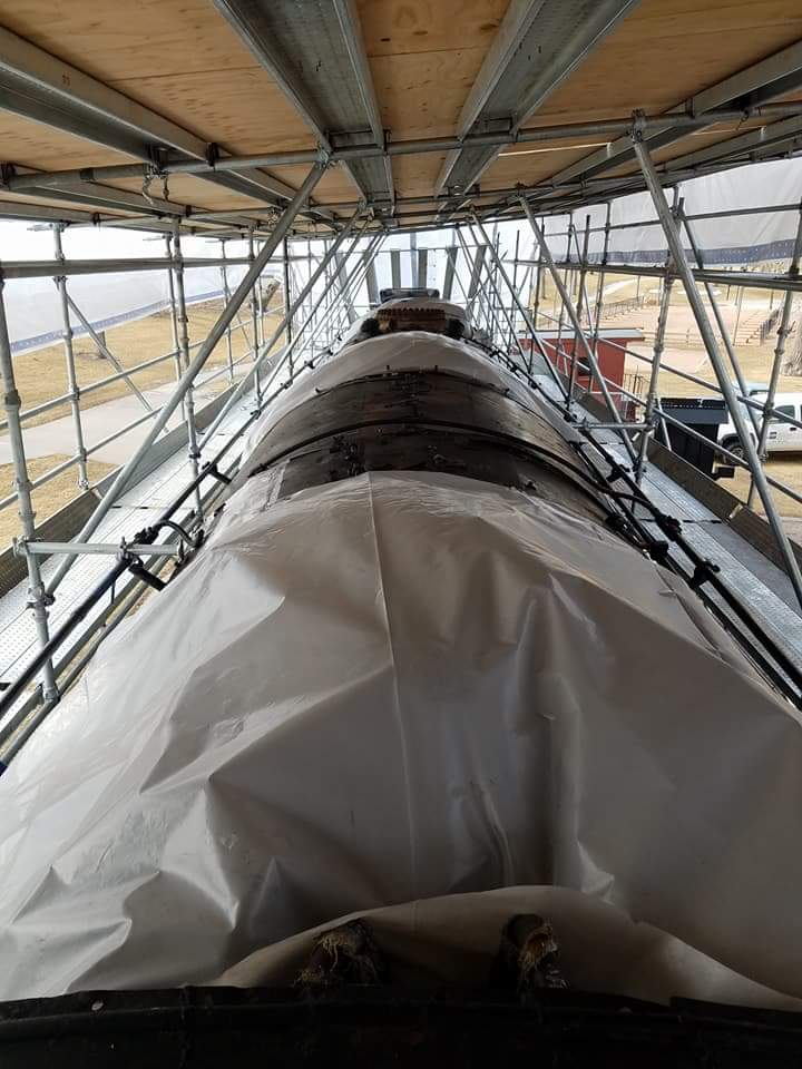

Meant to add more pictures apologies

I really appreciate any and all updates on the care and preservation of these beautiful machines. Thank you for getting the shots and posting.

Has it been sitting all these years with lagging still in place? That can't be good.
 Post subject: Re: 4004 disappears for a while
PostPosted: Fri Feb 09, 2018 12:51 pm
Posts: 3013
So what are the plans for the replacement?
I've seen various approaches, including wood spacers as well as simply removing the jacketing.
It doesn't seem like putting on new lagging would be needed, and on a non-operational locomotive, all that does is collect moisture and hold it against the boiler.
How will that be addressed?

I think we will be welding spacers in place, we will decide once the jacket is off how we proceed from there. so far the insulation is conpletely dry as was the 2000lbs of sand removed from the sand domes.
