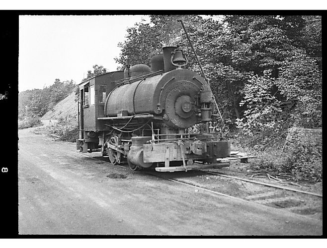

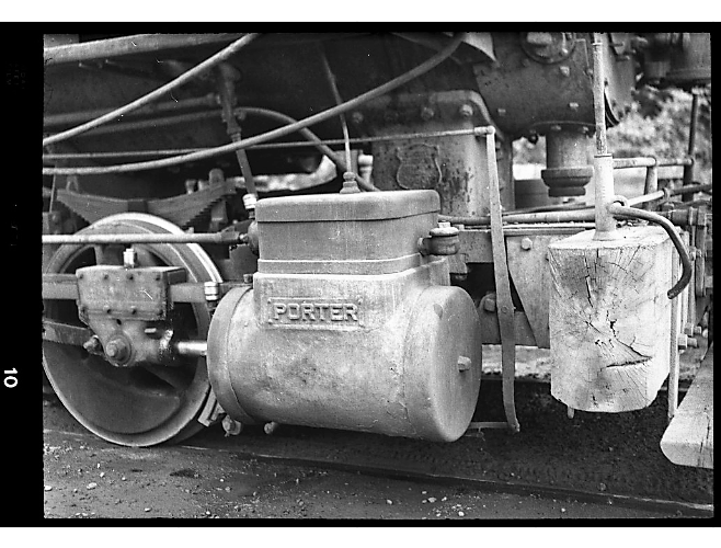

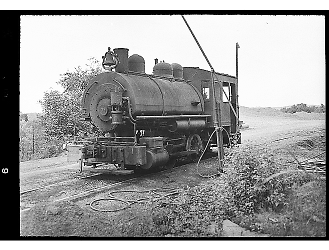

Hi Kevin
I have photos of her at Steamtown, in Vermont, over the years, if that is any help to you?
I also did find some photos on the web, that you must already have, but will post anyway.

Thanks, Pat I have seen a few of those photos. Ive tried the Canada Museum of Science and Csrm library and a few other Porter collections so far I have come up short. I am hoping to find an elevation drawing and other technical info. If anyone knows of any Porter collections or any place to look I would appreciate it.

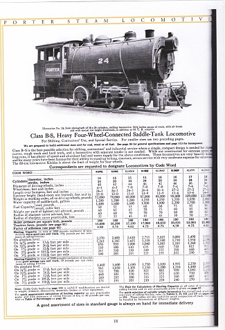

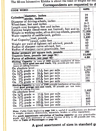

Hi Kevin
I have something else for you, the information is taken from the book, Porter Steam locomotives Light & Heavy by National Model Railroad Association, published in 2001.
I think you can still find the book, on eBay or Amazon.
Kevin the part of the page where I cropped, is the information dealing with number # 38.
If I find any more information on locomotive I will post, or PM you.
