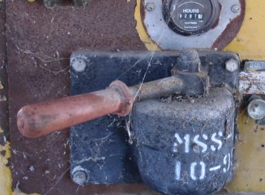

Slightly off topic, but I need help. The 23 tom GE switcher has an SA-2 straight air valve right now. Originally, it had a 14E1 valve. Why the change, I have no idea.
I need help identifying the red handled item in the center of the picture marked MSS
Thank you all for your help.
Bowmore,
MSS are the initials of who did the last rebuild/repair of that valve on the date below. All brake equipment get tagged when rebuilt, primarily to know who to blame if something happens, but also to keep track of the maintenance schedule. Same reasoning for the COT&S box on a railcar.
The why question, I can't answer, most likely parts availability or the SA-2 is the maintenance upgrade for the 14E1.
Bowmore,

Thank you for clarifying the markings. I am not conversant on brake systems, but my question is why are there two controllers? There is the one in the photo, plus there is the SA-2 valve.
We are still trying to get the diesel running, so the air system is down the line.
