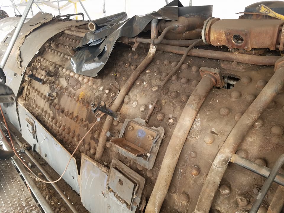

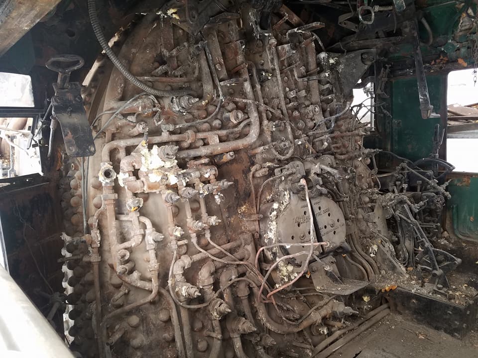

4004 in Cheyenne is well loved and having several hundred thousands spent including abatement.
29177820_10215361854495196_5594685959535853568_n.jpg [ 109.49 KiB | Viewed 9867 times ]
29214829_10215361855055210_9139892389609996288_n.jpg [ 113.53 KiB | Viewed 9867 times ]

What & When & why was that part cut off the boiler leaving a big square hole?
Steamcerely,
David Dewey
 Post subject: Re: Park Locomotives
PostPosted: Fri Mar 16, 2018 1:33 am
Posts: 825
Location: cheyenne
Hole was cut in 1978 for two staybolts for 3985
