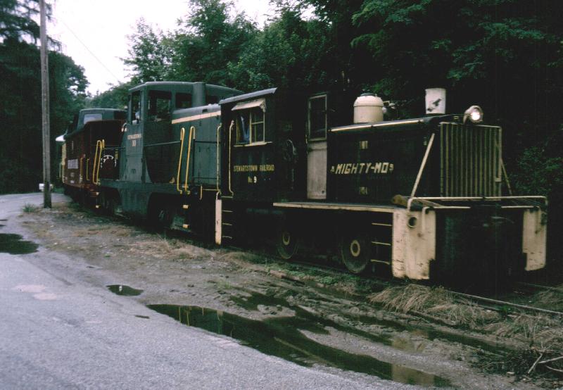

You might want to get in touch with someone at the Stewartstown Railroad in Pennsylvania. Their main motive power is a 1943 Plymouth locomotive (Mighty Mo) that still has a functioning LeRoi engine (the last I heard). They might be able to point you to potential parts sources.

Thanks. I just recently found out about them. Was browsing around on YouTube and came across it. Ironically mine has the nick name Moe also. I'm told that when the Locomotive was delivered to IH the employees were happy to have a Locomotive with "MOE" power! Hard telling what they were using before that.

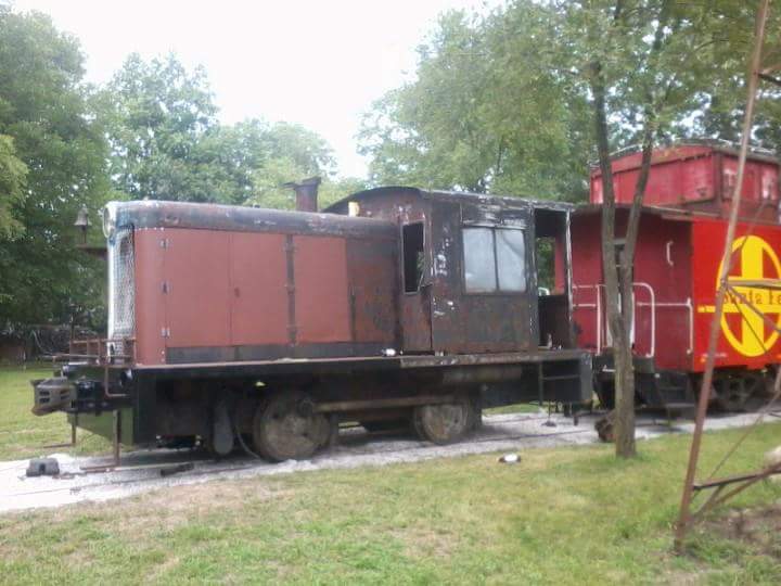

I have Davenport GM30 Serial # 2669 it has a LeRoi RSx1 inline 6 cylinder 1503cu.
According to my old IH contact the loco wasn't new when IH bought it, don't know if that is accurate or not. Anyway, here is a pic from when we first got the locomotive in 2013
