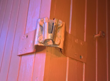

Attached is what your lantern brackets should look like, these are the ones on the CV 4052 at the Ct Eastern RR Museum, one we used was from the 4029 and one I made new for the restoration, the other 2 were originals from the 4052. You can get the lantern bracket casting (you had it in your hand) from WT Kirkman or Adlake (G Socket Marker Lamp Bracket). https://www.lanternnet.com/Merchant2/merchant.mvc?Screen=PROD&Store_Code=WKL&Product_Code=P232390&Category_Code=

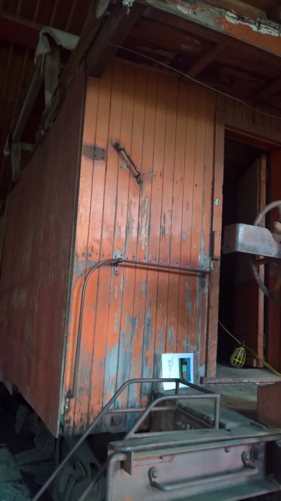

The bottom of lantern bracket is 103" above the rail head. There is no grab iron in the roof overhang like you were postulating in the video.

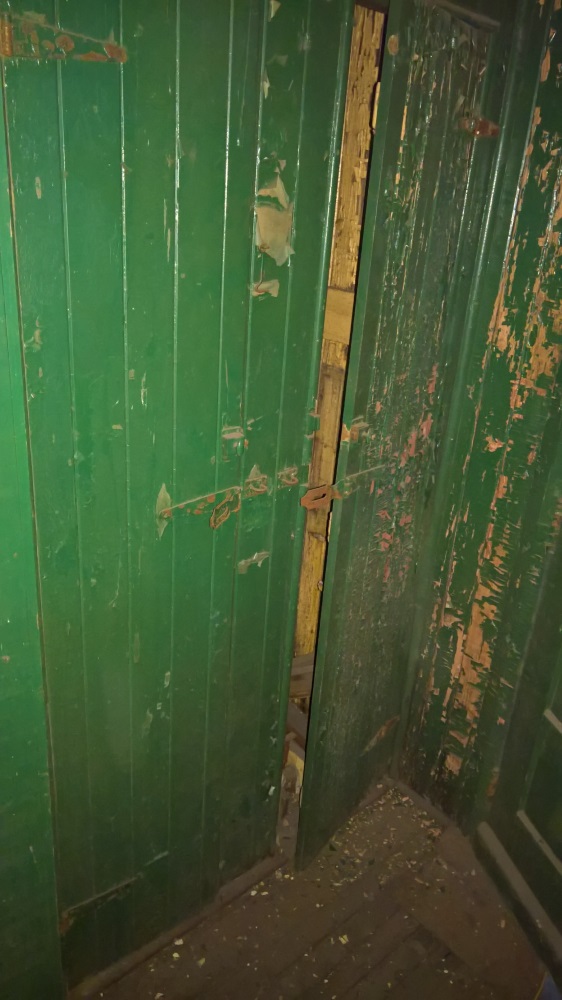

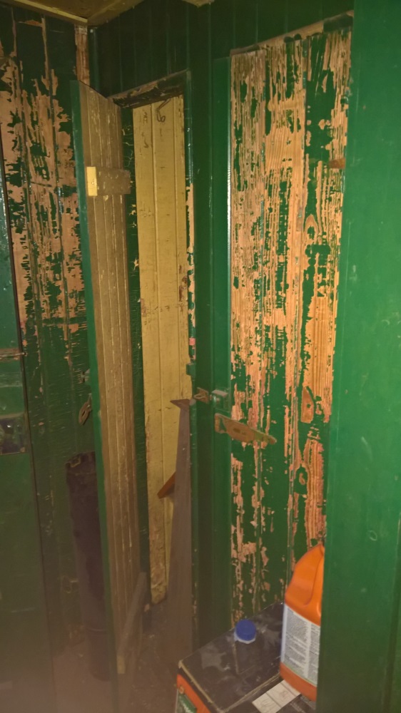

The closets inside the door under the short roof, the 2 on the left (I think currently is the toilet) were clothes closets with hanger rods and the pair on the right were for tools, lanterns and coupler parts and the tank for the Kerosene stove was in the first one.

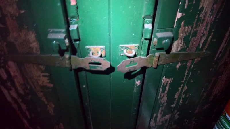

Closeup of the Closet latches, thought they would be drawbars like our other 2 cabeese.

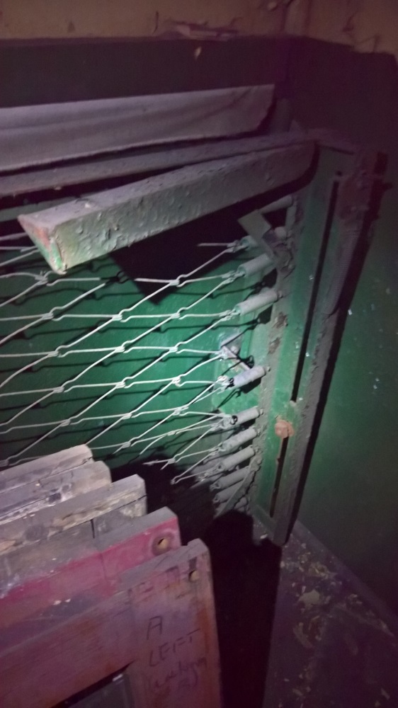

In the Cupola area, on the right side, on the door under the forward brakeman's seat is where the Fusee rack goes. (second upper cabinet on the right before you enter the large room).
The rod in the long room side of the cupola was to hang a blackout curtain so that the conductor could have the lantern burning while doing his paperwork, without impairing the night vision of the brakemen on watch in the cupola, while the train was traveling after dark.

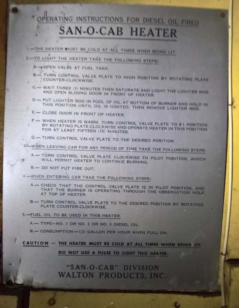

Continuing into the large room area, immediately on the right was the sink which drained through the floor and had a tap connected to the water tank behind the heater.

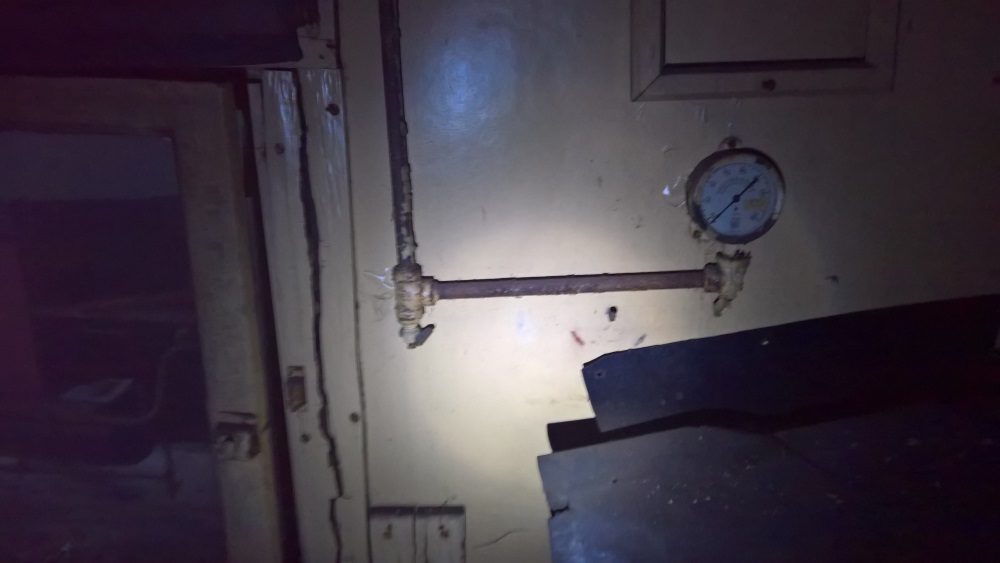

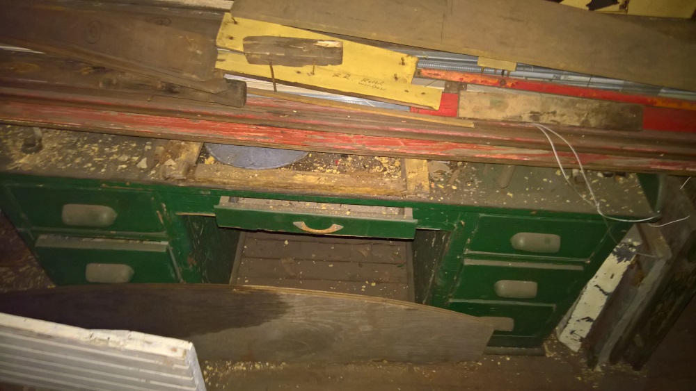

On the left is where the conductor's desk was located along with the gauge, there is only a condensation drain valve on the tee before the gauge. There are grab irons at both ends of the desk top, you can see the one on the left.

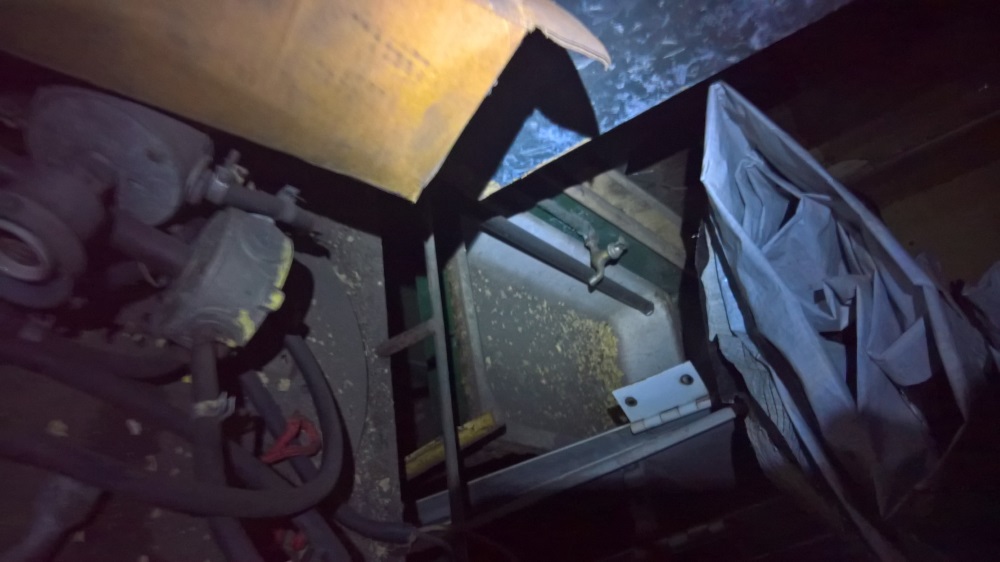

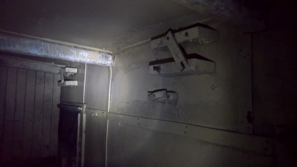

Real surprise was the seating area, the storage benches that are on the other 2 cabeese is not on the CV 4029. There were pivot out beds, we are missing the one on the right (where the drop table is, and that is the correct leg for the drop table in these cabeese). Because of other items in the caboose I was only able to photograph the last 2 feet of the bed, but you can see the folding leg, the mounting arm and the remains of a canvas cover that is mounted under the chair rail.
